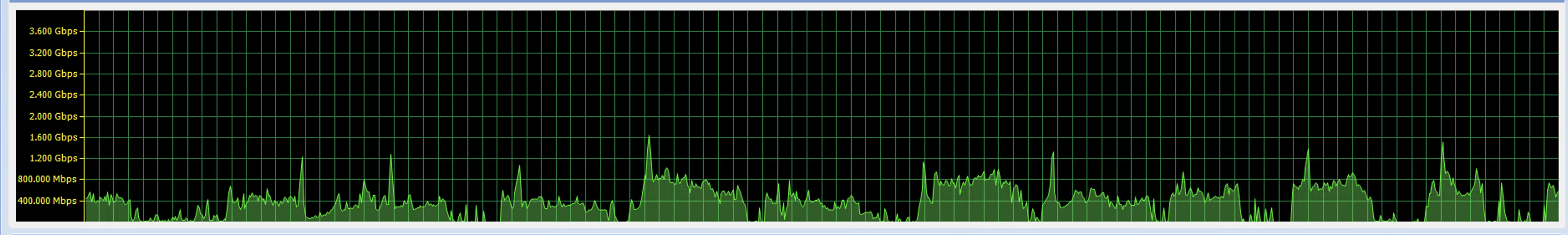

BIgdongdong1028 6 Posted July 21, 2023 Posted July 21, 2023 (edited) My Emby server experiences network traffic anomalies every day after 5 PM, characterized by unresponsive data and a sudden drop in outgoing data traffic to just a few Mbps. Normally, the server sends data traffic at several hundred Mbps to 2 Gbps due to high traffic from users accessing the server. This issue persists until 12 AM, after which everything returns to normal. I have checked for all hardware issues and found no abnormalities. I have also reinstalled the Emby service, but this has not resolved the issue. The problem has been ongoing for about two weeks now and remains unresolved. Could anyone please help me? Edited July 21, 2023 by BIgdongdong1028
rbjtech 5335 Posted July 21, 2023 Posted July 21, 2023 If this is traffic ingress, then unless another scheduled task is running taking all your upload bandwidth, I would point the finger at your ISP throttling your upload speed.
BIgdongdong1028 6 Posted July 22, 2023 Author Posted July 22, 2023 17 hours ago, rbjtech said: 如果这是流量入口,那么除非另一个计划任务正在运行占用您所有的上传带宽,否则我会将矛头指向您的 ISP 限制您的上传速度。 There are no other programs occupying the upload bandwidth. The picture I posted above is the total bandwidth monitored on the network interface

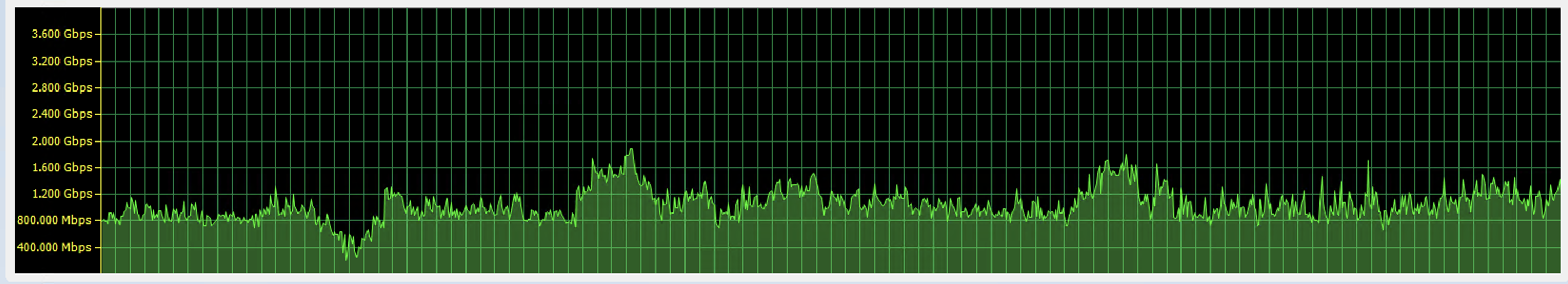

BIgdongdong1028 6 Posted July 22, 2023 Author Posted July 22, 2023 This is the normal network traffic condition. I suspect it might be caused by human intervention, as it occurs at a fixed time every day from 5 pm to 12 am. 1

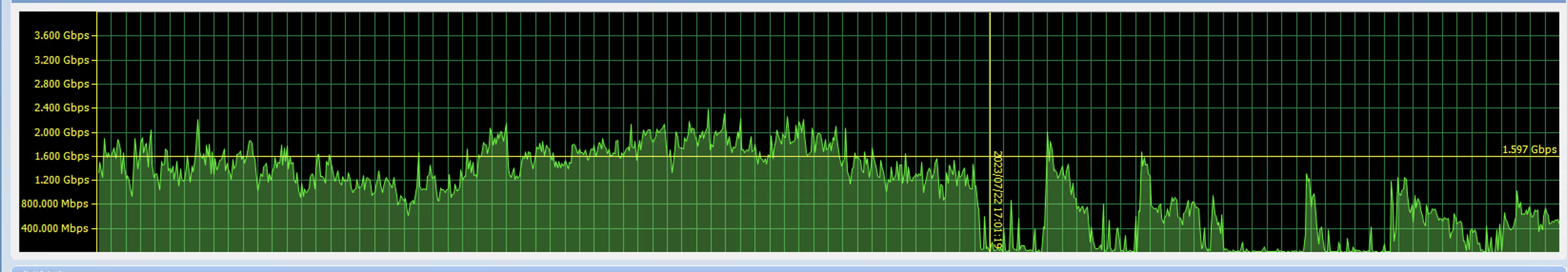

BIgdongdong1028 6 Posted July 22, 2023 Author Posted July 22, 2023 Let me add some more information After 5 pm, not all programs stop sending traffic. Everything works fine when I use iperf or other programs, but there is no traffic for Emby. The lack of traffic is not constant, but intermittent. There is no traffic for one minute, and then there is traffic for the next minute Does anyone know how I can troubleshoot the problem?
