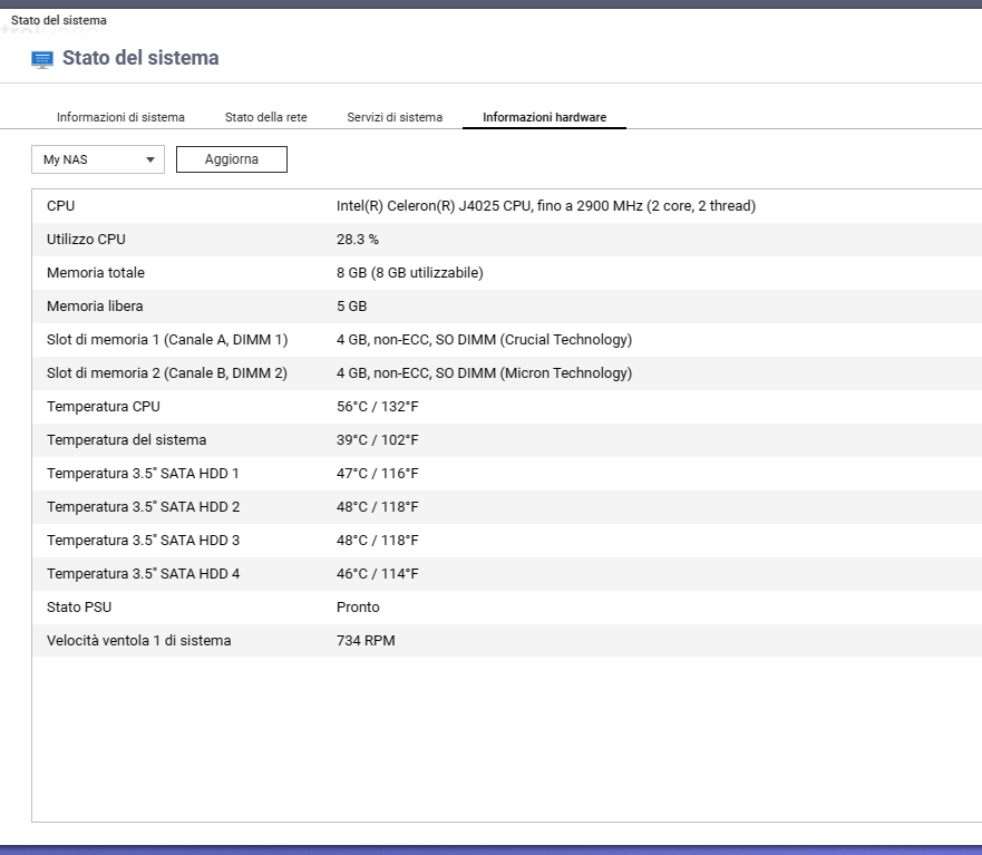

Super957 24 Posted July 21, 2023 Posted July 21, 2023 (edited) 1 hour ago, seanbuff said: Hi, what is your current database cache size set to? Depending on how much system RAM your QNAP has, you can try increasing your cache size to squeeze some more performance from your server (eg. noticeably faster loading times, etc) See this guide: Ok i follow post of performance tweaks and this is may situation: My Qnap has 8GB My library.db is 181 MB and these screenshot Thank Hispa Edited July 21, 2023 by Super957
