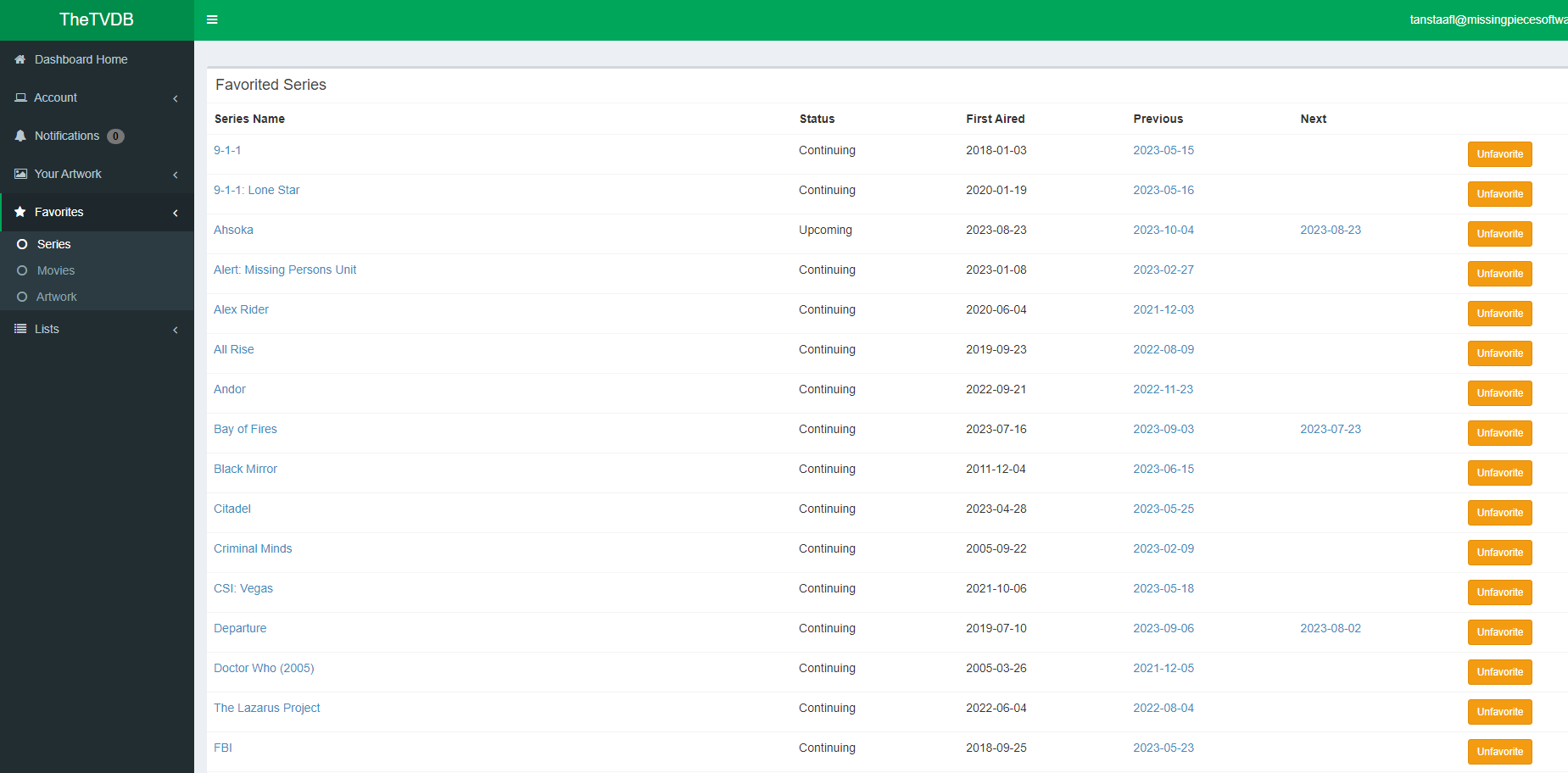

tanStaafl 15 Posted July 20, 2023 Posted July 20, 2023 This apparently just started, but I have added 3-4 new tv shows and I have checked tvdb and they show all their upcoming episodes but they are not showing up in my upcoming list in EMBY. I have rescanned and double checked that the libraries have tvdb checked as a fetcher. Not sure what else to do. Thanks in advance for any help!
