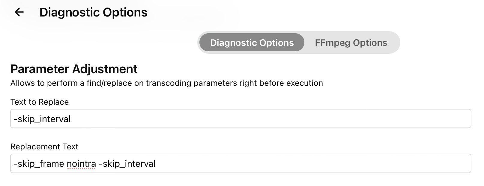

rbjtech 5335 Posted July 19, 2023 Posted July 19, 2023 8 hours ago, K22R8CT said: 2. Is there some way I can hack it in? Yes - install the 'Emby Diagnostics' plugin - and then use the 'Parameter Adjustment' to 'search and replace' the syntax you want to try. This works for any ffmpeg command. But ideally - try and provide the logs to get it fixed. I have not noticed any performance issues with HEVC files. 1
K22R8CT 25 Posted July 19, 2023 Author Posted July 19, 2023 1 hour ago, rbjtech said: install the 'Emby Diagnostics' plugin - and then use the 'Parameter Adjustment' to 'search and replace' the syntax you want to try. Either I've done something wrong or it doesn't apply to thumbnail-generation: Resultant command (no "skip_frame") 2023-07-19 07:48:25.340 Info App: ProcessRun 'quick-extract-imageseries' Execute: /bin/ffmpeg -f mp4 -threads 1 -skip_interval 10 -copyts -i file:"/media/Movies/Default/Movie.mp4" -an -sn -vf "select='eq(pict_type,PICT_TYPE_I)',scale=w=320:h=180" -vsync cfr -r 0.1 -f image2 "/config/cache/temp/a8a64408e49d4e2da992f967c7231ee0/img_%05d.jpg" 1 hour ago, rbjtech said: But ideally - try and provide the logs to get it fixed. Aside from entries like the one above I don't see anything thumbnail-related in the logs. Are they in another log? Do I have to increase the log level? I've played around some and it looks like the slowness is video-specific. HEVCs I've encoded myself (8 bit) seem fine. The common element with the problem files is yuv420p10le Video: hevc (Main 10) (hev1 / 0x31766568), yuv420p10le(tv, bt709, progressive) But I'll test more to confirm. 1

softworkz 5124 Posted July 20, 2023 Posted July 20, 2023 12 hours ago, K22R8CT said: If the measurement fps=0.3 is analogous to transcoding speed that seems very bad. Well - that's the fps of the frames being output, i.e. your thumbnail images. The speed is 2.9x and the framerate 24 fps, that makes a processing speed of 70 fps (input frames). The pict_type filter is only applied when the container is MP4. The reason is that with MP4 there are problems with keyframe seeking. I don't remember whether this was generally with MP4 or just with certain MP4 files, but even in the latter case - we can't know this in advance and so we have to apply this filter always for MP4 files. Using -skip_frame might be faster, but I'm almost certain that you won't get accurate results this way (first compare the number of images output, then compare the images at certain positions). My recommendation is: Use MKV as container Encode the video with keyframes at a constant frequency (3 or 6 seconds), even when the files get a bit larger. 1 1
softworkz 5124 Posted July 20, 2023 Posted July 20, 2023 18 hours ago, rbjtech said: Yes - install the 'Emby Diagnostics' plugin - and then use the 'Parameter Adjustment' to 'search and replace' the syntax you want to try. This works for any ffmpeg command. It doesn't work for image extraction... 1
