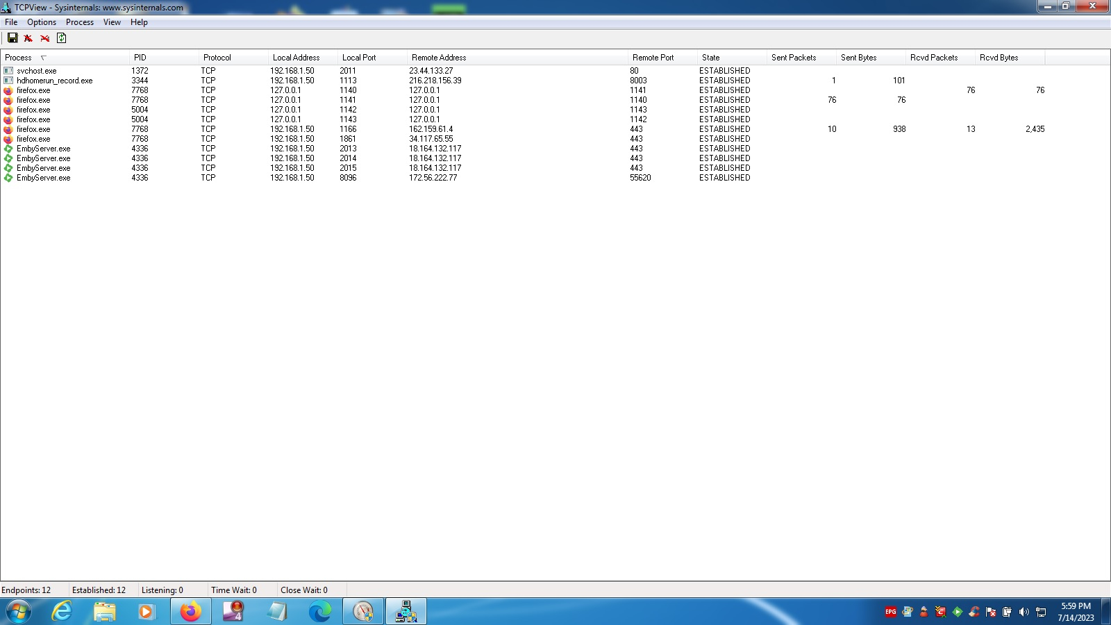

JohnsLibrary 9 Posted July 14, 2023 Posted July 14, 2023 I have noticed that whenever I connect to Emby server from outside my local net, Emby will simultaneously connet to servral other IP address's some of which are on Amazon, AmazonAWS, Google and Cloudfront. I'm an Emby Premier user and would prefer if I could turn off these remote connections rather than having to block them through my router firewall, or please explain why connecting to these IP addresses is necessary to use Emby. Thanks.

JohnsLibrary 9 Posted July 14, 2023 Author Posted July 14, 2023 Hello, I have no idea of the "why it is happening", only what my router log sees when establishing a connection to Emby. I can clearly see that at the exact time I connect via my smartphone I can see several other IP address outbound at the same time. I have attached a screenshot of tcpview which shows emby connecting to ip 18.164.132.117. IP 172.56.222.77 is T-mobile, which is my smartphone.
Luke 42185 Posted July 14, 2023 Posted July 14, 2023 If you can provide the emby server log maybe we'll spot something. Maybe you installed a plugin that is doing that, but there is nothing built into the server that is using google, amazon or cloudfront services.

seanbuff 1353 Posted July 15, 2023 Posted July 15, 2023 27 minutes ago, TMCsw said: It was simply answering the phone.. OP already indicated that 172.56.x.x was his T-Mobile smartphone and is aware of that one. 3 hours ago, JohnsLibrary said: IP 172.56.222.77 is T-mobile, which is my smartphone. They are referring to the 18.164.132.117 remote address which is an Amazon Cloudfront owned IP. Won't know more until logs are supplied.

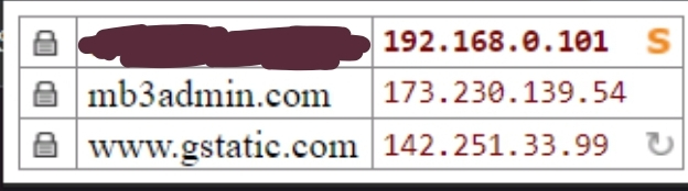

darkassassin07 671 Posted July 15, 2023 Posted July 15, 2023 (edited) Whenever I load my web app, the browser pulls fonts from gstatic.com googles static file domain. (had to add it to the csp a while ago) Here's a screenshot from IPvFoo, listing all domains used on the page and the ip they mapped to at the time. Perhaps that explains the google connections? No idea about amazon/cloudfront. Edited July 15, 2023 by darkassassin07
Luke 42185 Posted July 15, 2023 Posted July 15, 2023 27 minutes ago, darkassassin07 said: Whenever I load my web app, the browser pulls fonts from gstatic.com googles static file domain. (had to add it to the csp a while ago) Here's a screenshot from IPvFoo, listing all domains used on the page and the ip they mapped to at the time. Perhaps that explains the google connections? No idea about amazon/cloudfront. There’s nothing in the built in web app pulling a font from gstatic. Could be plug-in or custom css related. If you're in the chrome browser though, it could also be the chromecast sender libraries.

JohnsLibrary 9 Posted July 16, 2023 Author Posted July 16, 2023 So, after removing all the plug-ins fro Emby, only one connection other than localhost remains, 18.164.132.117. An IP Whois on this IP states it's Amazon(cloudfront.net). I've blocked the IP from connecting and Emby seems to work normally. Can anyone list the server IP address's that Emby needs for Guide data, etc.?

JohnsLibrary 9 Posted July 16, 2023 Author Posted July 16, 2023 1 hour ago, JohnsLibrary said: So, after removing all the plug-ins fro Emby, only one connection other than localhost remains, 18.164.132.117. An IP Whois on this IP states it's Amazon(cloudfront.net). I've blocked the IP from connecting and Emby seems to work normally. Can anyone list the server IP address's that Emby needs for Guide data, etc.? UPDATE: It looks like my original statement about blocking IP 18.164.132.117 was false. I have found that if it's blocked, remote live tv gets broken and refuses to stream.
