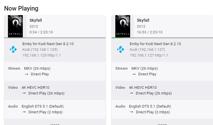

jang430 10 Posted August 14, 2023 Author Posted August 14, 2023 (edited) Yes. Still have the same issue. I have below screenshot of emby server activities. Both devices connected via wireless to the same tv, Input 1 and Input 4. Both devices playing the same file at the same time. The A95X plays this without a glitch, while the Chromecast stutters to unacceptable levels. Edited August 14, 2023 by jang430

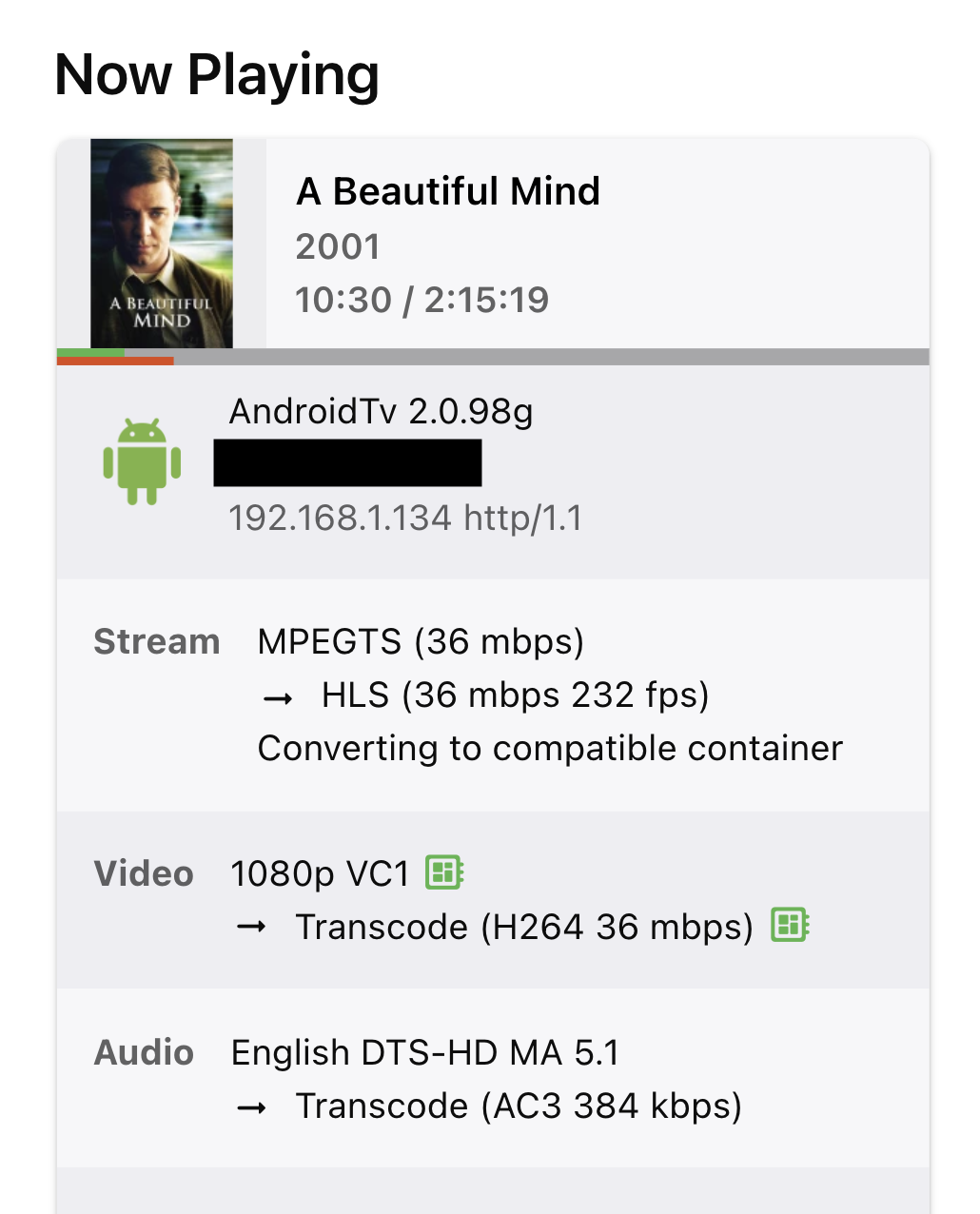

jang430 10 Posted December 11, 2023 Author Posted December 11, 2023 Sorry, I just took a picture of the stats from the TV. Less stopping when using emby app on Google TV. Major stop/ start when using Kodi on same device. Kodi says "read rate too low for continuous playback."
rbjtech 5344 Posted December 11, 2023 Posted December 11, 2023 (edited) 8 minutes ago, jang430 said: Sorry, I just took a picture of the stats from the TV. Less stopping when using emby app on Google TV. Major stop/ start when using Kodi on same device. Kodi says "read rate too low for continuous playback." .. giving you a very specific clue about why you have issues. Either it can't read the data fast enough off the disk (hence my SSD comment earlier) or your wifi/ethernet connection to the end device is simply not good enough and cannot sustain the required bitrate. (wifi4 is a big clue here..) Edited December 11, 2023 by rbjtech
jang430 10 Posted December 11, 2023 Author Posted December 11, 2023 Before WiFi 4, 2.4 GHz, I had it connect to 5 GHz. I had the same experience. But I'll give it another try.
jang430 10 Posted December 11, 2023 Author Posted December 11, 2023 How much speed is needed to stream such file? from 9.92 to 48.9 Mbps? I'm still experiencing the same issues.
