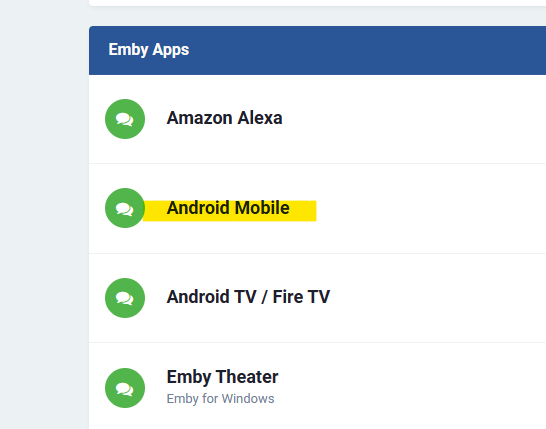

rbjtech 5344 Posted July 11, 2023 Posted July 11, 2023 (edited) I do wish the 'Android Mobile' Forum section could be changed to remove the word 'Mobile' - as posting a problem on Android in the AndroidTV/FireTV section (that doesn't have the problem) just adds to the overall confusion between the two. I had to re-read the post to confirm the OP is talking about the Android App, not the AndroidTV App. @Abobader@Luke@ebr Could this maybe get changed to 'Android App' or something like that ? Thanks. Edited July 11, 2023 by rbjtech
ebr 16337 Posted July 11, 2023 Posted July 11, 2023 3 hours ago, rbjtech said: I do wish the 'Android Mobile' Forum section... At first I kind of agreed but I think it helps us more right now to keep the discussion of TV-specific issues separate from normal standard Android usage. Eventually, we'll just merge the forums into one. 1
