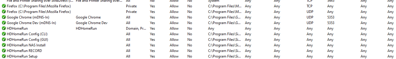

softworkz 5135 Posted July 11, 2023 Posted July 11, 2023 Just to give you an example: Neither FireFox nor Chrome nor HDHomeRun have ever asked me about making those entries. This is a standard procedure of app installation on Windows. The confusing point is rather that Emby uses explicit ports which creates a wrong impression admittedly. We should change to 'Any' like others do. This will reduce hazzle and confusion.
Guest Posted July 11, 2023 Posted July 11, 2023 2 minutes ago, softworkz said: Just to give you an example: Neither FireFox nor Chrome nor HDHomeRun have ever asked me about making those entries. This is a standard procedure of app installation on Windows. The confusing point is rather that Emby uses explicit ports which creates a wrong impression admittedly. We should change to 'Any' like others do. This will reduce hazzle and confusion. I get what you are saying, I also don't agree with hdhomerun or chrome / firefox or any app really making determinations for me. I also completely understand that I take a very paranoid approach to this where most could not care less.
softworkz 5135 Posted July 11, 2023 Posted July 11, 2023 32 minutes ago, lukeoslavia said: I get what you are saying, I also don't agree with hdhomerun or chrome / firefox or any app really making determinations for me. I also completely understand that I take a very paranoid approach to this where most could not care less. Being paranoic is sometimes a good thing, but in this case it's not justified. The problem here is that when thinking about this, your mind quickly converges to logical patterns and relations of entities that we have learned from network firewall purposes and behaviors. But this is something different. This is not drilling a hole into your computers security in any way, because those rules are scoped to the application - it's not about opening access to your system. During installation of applications on Windows, you usually need to confirm the UAE prompt, which in turn gives the setup full permission to do on your system whatever it needs (or wants) to do - to prepare it for running the application. That's why you (should) do this only when trust an application. Emby is a personal media server - there's no point in using it just locally, and so there is no point in questioning the user about whether they wants the firewall entries (futurely 'Any') to be made or not. Because the "Or Not" choice would mean to stop and cancel the Emby installation. I think it's pretty clear to everybody that Emby Server needs to communicate on the network, so it would be really pointless to ask during installation whether user wants to cancel due to Emby Server requiring network access...
Guest Posted July 11, 2023 Posted July 11, 2023 5 minutes ago, softworkz said: Being paranoic is sometimes a good thing, but in this case it's not justified. The problem here is that when thinking about this, your mind quickly converges to logical patterns and relations of entities that we have learned from network firewall purposes and behaviors. But this is something different. This is not drilling a hole into your computers security in any way, because those rules are scoped to the application - it's not about opening access to your system. During installation of applications on Windows, you usually need to confirm the UAE prompt, which in turn gives the setup full permission to do on your system whatever it needs (or wants) to do - to prepare it for running the application. That's why you (should) do this only when trust an application. Emby is a personal media server - there's no point in using it just locally, and so there is no point in questioning the user about whether they wants the firewall entries (futurely 'Any') to be made or not. Because the "Or Not" choice would mean to stop and cancel the Emby installation. I think it's pretty clear to everybody that Emby Server needs to communicate on the network, so it would be really pointless to ask during installation whether user wants to cancel due to Emby Server requiring network access... I might not be clear enough here. My issue isn't that emby would likely need to be accessed outside of the local machine, the issue is that it is opening ports to listen on any IP address, not just allowing traffic to emby, which isn't clear in the settings or during setup. Which you are in some way addressing in the future. I don't think its fair to argue that "This is not drilling a hole into your computers security in any way". You are allowing traffic on those ports from any IP address on the local network, which isn't always okay. I also am not saying to ask for network access in general, I'm asking to be able to set emby's IP address and Port to one of a users choosing during setup. The option can even be prefilled with the default port and a wildcard in the host/IP address section, in addition to that, if we change our port to something else in the future clean up the previous one, or potentially tell a user they should check into it. I don't believe we will see eye to eye on this. I get the reasoning for what is happening, but it's a reason of convince imo.
