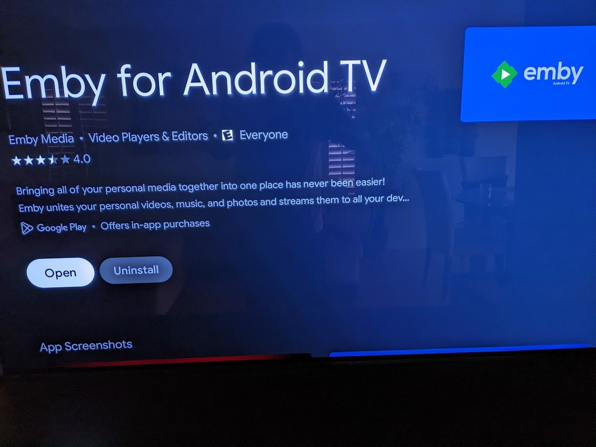

musicmafia 38 Posted July 9, 2023 Author Posted July 9, 2023 4 hours ago, Luke said: Hi. Can you try sideloading our standard android app on the same device and see how that compares? https://emby.media/emby-for-android.html Thanks. Hey Luke! I'm pretty sure that's what I originally installed on the TV from the Google Play store. Do you want me to uninstall/reinstall or do something different? Thanks
Luke 42185 Posted July 9, 2023 Posted July 9, 2023 That's our TV app. You can leave it installed. Can you try sideloading the app that I linked you to? Thanks. 1
musicmafia 38 Posted July 9, 2023 Author Posted July 9, 2023 5 minutes ago, Luke said: That's our TV app. You can leave it installed. Can you try sideloading the app that I linked you to? Thanks. Sorry, I'm not following. Guess I need to read Sideloading for Dummies. You want me to do this on the TV? When I search Google Play apps on the TV, the only Emby app I see is the Android TV app. How do I locate the other one?

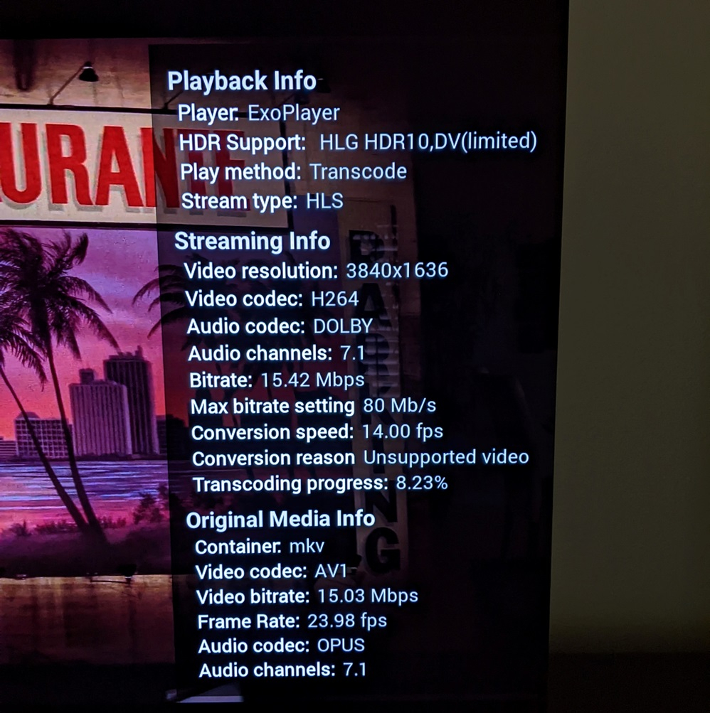

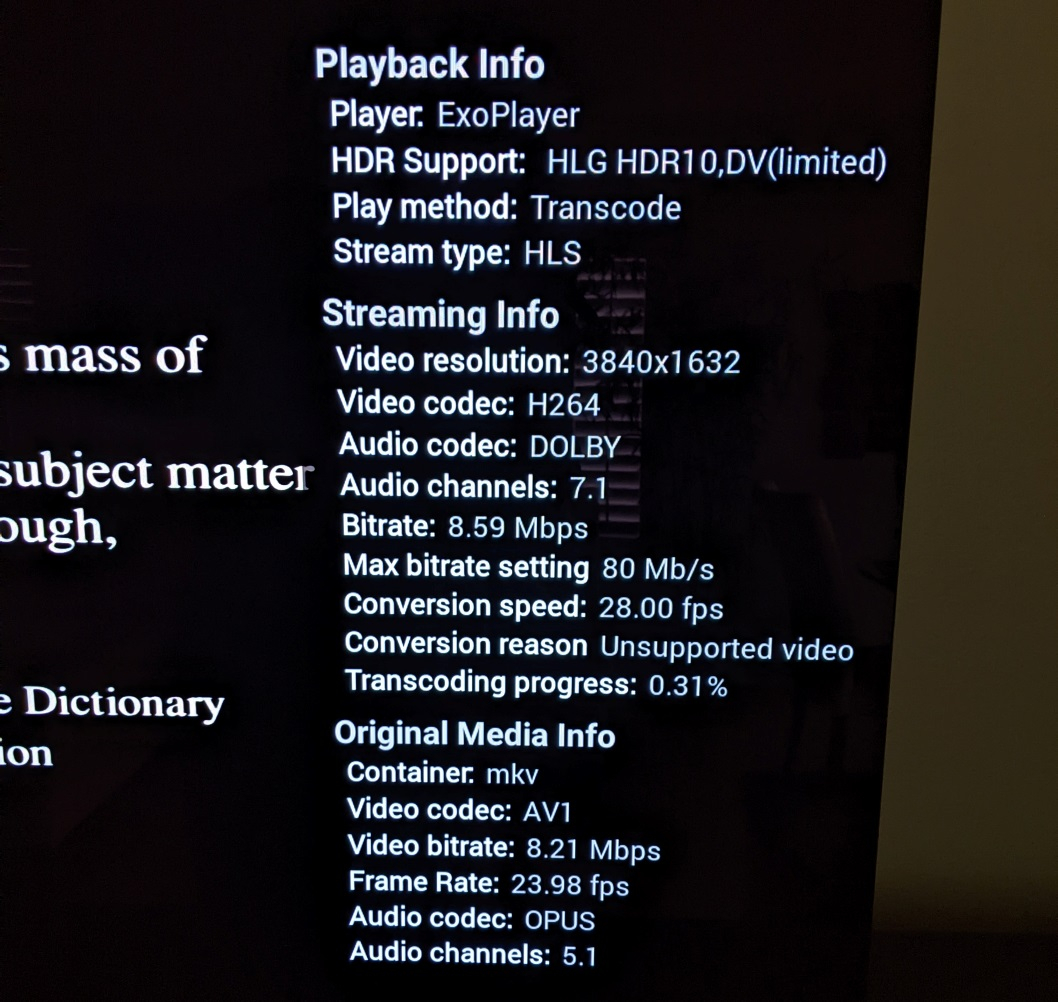

musicmafia 38 Posted July 14, 2023 Author Posted July 14, 2023 The pics below are from the original emby TV app. I was unable to bring up Stats for Nerds on the Android app I sideloaded. I will try and figure out the logs next.

ebr 16307 Posted July 14, 2023 Posted July 14, 2023 11 hours ago, musicmafia said: The AV1 files are still stuttering Yes I'm not surprised as I doubt your TV has enough power to decode AV1 in software. Also, from your images, it appears your server is not powerful enough to convert it fast enough. You are only getting 28fps which explains the buffering. 1
