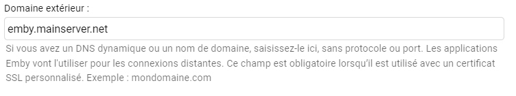

nunuxx 7 Posted July 8, 2023 Posted July 8, 2023 Hi, I'm using Emby into my MAIN server, everything work fine. Then I add a "proxy_pass (nginx) server" located another country to handle all my service from my MAIN server, everything work fine too here is my nginx "proxy_pass server" config : server_name emby.proxypass.com; location / { proxy_pass https://emby.mainserver.net:8920; sub_filter 'https://emby.mainserver.net' 'https://emby.proxypass.com'; sub_filter_once off; proxy_set_header X-Real-IP $remote_addr; proxy_set_header X-Forwarded-For $proxy_add_x_forwarded_for; } Problem is : I add my main server to EMBY > emby.mainserver.net > All is OKAY I add my proxy_pass server to EMBY > emby.proxypass.com > not OKAY > The server added, but when I close the app and restart it's still show the MAIN server ------------------------------- Do I need to add "emby.proxypass.com" to my emby settings ? Here is what I did : Can I add comma et add my proxy_pass server ? But what about the SSL certificate (I can only put ONE) Have you got some ideas to help ? thank you
Luke 42242 Posted July 8, 2023 Posted July 8, 2023 Hi, yea you can't use two with a comma, it will only accept one. Why not just put the proxy pass one there if that's what you want?

Q-Droid 1011 Posted July 14, 2023 Posted July 14, 2023 I think the issue for the OP is not the multiple domains as server entry points but that the Emby server itself only supports one domain to announce to apps. So when the app requests the server connection settings from Emby it can only provide the one domain specified. This is not a problem with browser connections. - App connects to Emby using given xyz domain. - App works with xyz but still requests connect info from server. - Server sends abc domain from settings. - Next time app opens it uses abc domain sent by Emby server. Header rewrites can often help but in this case it's not headers but response data which contains the server connection info going back to the apps. I don't know if there's a simple way to translate that info using the web server/proxies.
