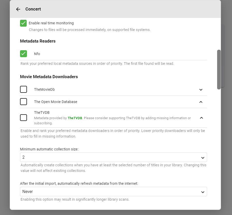

robbie1407 4 Posted July 8, 2023 Author Posted July 8, 2023 the only option i see is this one where about is that located? thanks
Luke 42185 Posted July 9, 2023 Posted July 9, 2023 Try using the toggle in the upper right to show advanced settings, then there will be a new option to prefer embedded titles over file names.

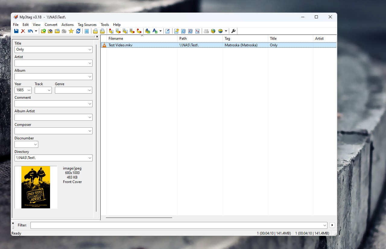

robbie1407 4 Posted July 10, 2023 Author Posted July 10, 2023 so in a update i can confirm that mp4 year in mp3tag works, however emby does not read mlv embedded tags for mkv files, any idea why this would be? thanks robbie

robbie1407 4 Posted July 10, 2023 Author Posted July 10, 2023 i uploaded the video ive been testing. https://mega.nz/file/QuF12QJI#PjtBYl_hjsnIHs9a1ErXLYlE-qS5KLCz1pqMfJmFA6Y artwork works ok title ok tried different date formats, and cannot get date to work. is it also possible to add description of video into embedded tags? thankyou
Luke 42185 Posted July 10, 2023 Posted July 10, 2023 Quote is it also possible to add description of video into embedded tags? already supported with the description tag.
Luke 42185 Posted July 10, 2023 Posted July 10, 2023 18 minutes ago, robbie1407 said: i uploaded the video ive been testing. https://mega.nz/file/QuF12QJI#PjtBYl_hjsnIHs9a1ErXLYlE-qS5KLCz1pqMfJmFA6Y artwork works ok title ok tried different date formats, and cannot get date to work. is it also possible to add description of video into embedded tags? thankyou Tested. Title works just fine. There is date or year value tagged into this file, except for DATE_RECORDED, but we can't really use that to populate release year. If you want to populate the release date or year, use the DATE field, or RETAILDATE.
