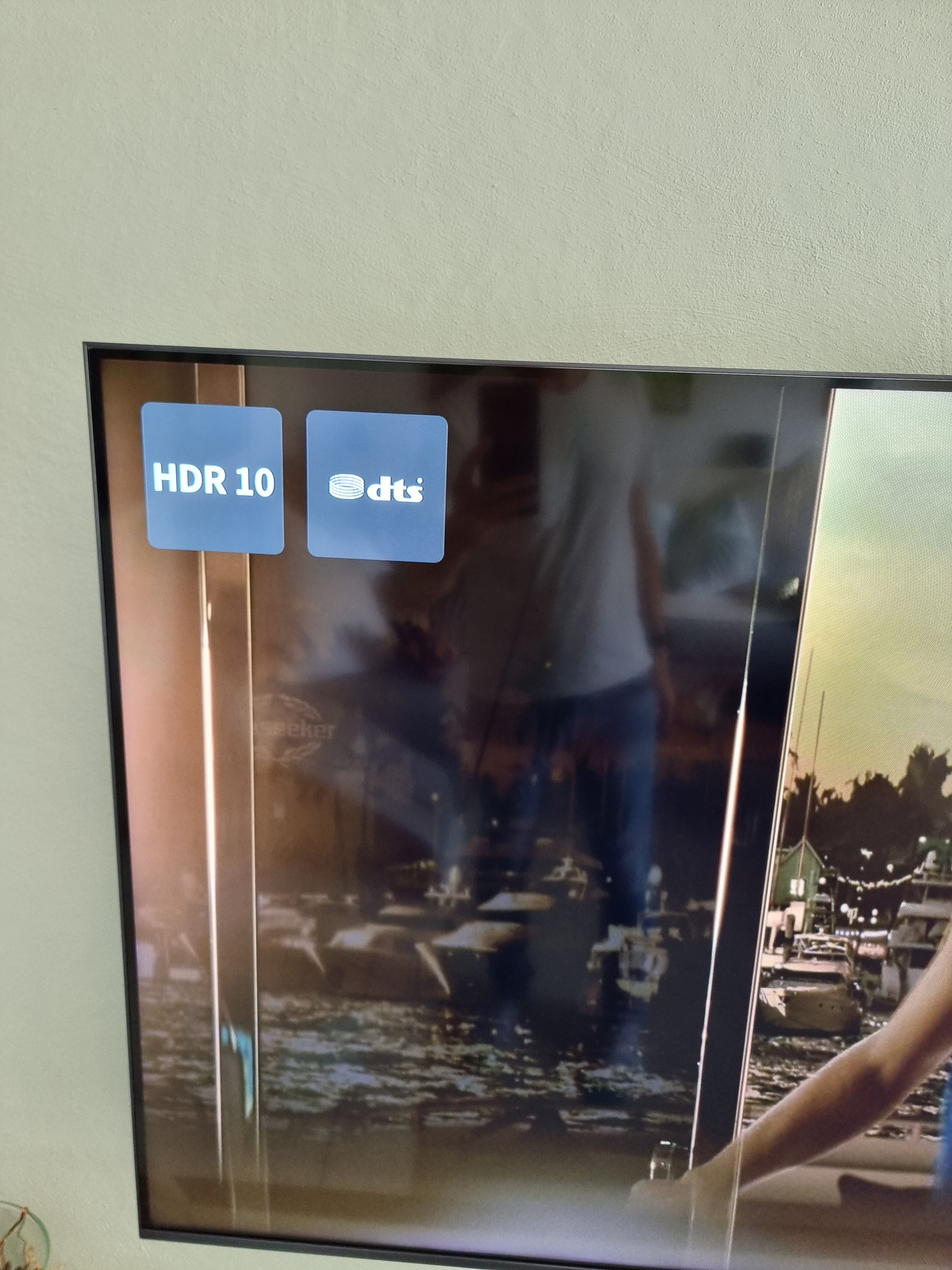

CoryRosenberg 3 Posted July 6, 2023 Author Posted July 6, 2023 as you can see DTS doesn't activate when being played with embedded player, but works fine with VLC. If I use the Emby player it just converts to stereo. embyserver.txt
