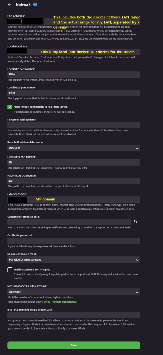

I don't think I changed anything on my Emby config when I migrated from NPM to Traefik but I might have done something before using NPM and I can't recall. Give me a few minutes and I'll try to get you some screenshots of what my Emby network config look like.
When you say it doesn't work with Emby, what do you mean? What error do you get, have you checked the logs? is there a chance that you asked for too many certs in the production caServer and now you are timed out for a few days?
EDIT: Added screenshot with my network settings
