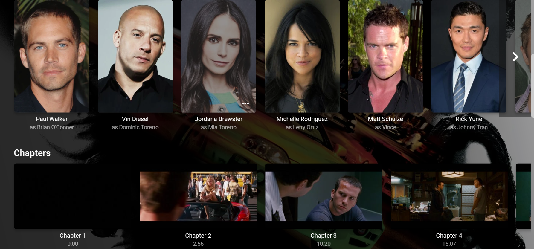

JCoryShe 3 Posted July 5, 2023 Posted July 5, 2023 Im not sure if this is the correct place but I noticed on a couple of my movies that the chapters that were being shown belong to a totally different movie. As and example we were watching Fast and the furiious but the chapters showing up on the player belonged to Tokyo Drift. I was wondering how to fix this

JCoryShe 3 Posted July 5, 2023 Author Posted July 5, 2023 (edited) Ive seen these movies alot. you can hover over a part and shows a completley differnt scene of another movie The actor in all the chapters isnt even in the first movie Edited July 5, 2023 by JCoryShe
rbjtech 5335 Posted July 5, 2023 Posted July 5, 2023 11 minutes ago, JCoryShe said: Ive seen these movies alot. you can hover over a part and shows a completley differnt scene of another movie The actor in all the chapters isnt even in the first movie Hmmm - that is strange ! Is it just this one movie with the issue ?

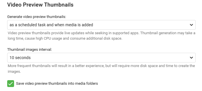

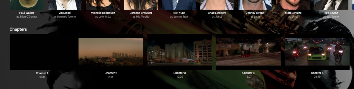

rbjtech 5335 Posted July 5, 2023 Posted July 5, 2023 ok - so the chapters look ok - but my images are different ... How odd. Delete the BIF file and then run a Metadata Refresh as shown below :-

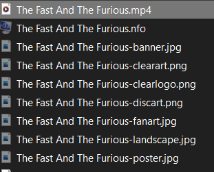

rbjtech 5335 Posted July 5, 2023 Posted July 5, 2023 Unless you have set the option above, the bIF files may be local - and I'm not sure how you can identify and delete that one ...
JCoryShe 3 Posted July 5, 2023 Author Posted July 5, 2023 Its only that file i have the bif file for all the other movies in the folder
