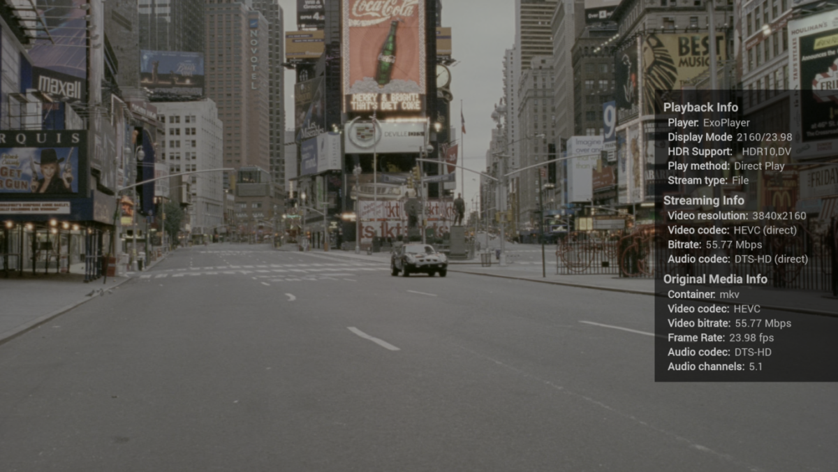

skooogis 7 Posted July 5, 2023 Posted July 5, 2023 Hi, yesterday I had some issues with my Shield Pro. I first noticed that the "HDR"-logo on my LG tv didnt show up, and when I look at the statistics I saw that it was a directplay-error. Have not had this issue with any media for a long time. When I switched to LG-app, HDR logo showed up and directplay worked. Attached are logs Best regards embyserver-63823852800.txt ffmpeg-directstream-36895787-8517-4387-84e1-1ee889371352_1.txt ffmpeg-directstream-c81db968-448d-41e6-ab84-9f742e3d1d99_1.txt ffmpeg-transcode-2cd4d79a-2ecd-46c7-90c4-02e28ae1b7f8_1.txt ffmpeg-transcode-fe54ad30-b941-4bc8-b4d9-71ac44d133b1_1.txt

skooogis 7 Posted July 8, 2023 Author Posted July 8, 2023 On 7/7/2023 at 4:41 PM, ebr said: Yep, something about this particular item is giving Exo a problem. playerFailed [eventTime=0.46, mediaPos=0.00, window=0, period=0, errorCode=ERROR_CODE_IO_UNSPECIFIED Can you try with the latest beta? In beta it gets recognized as HDR but not DV. Plex-app recognizes same media as DV.
