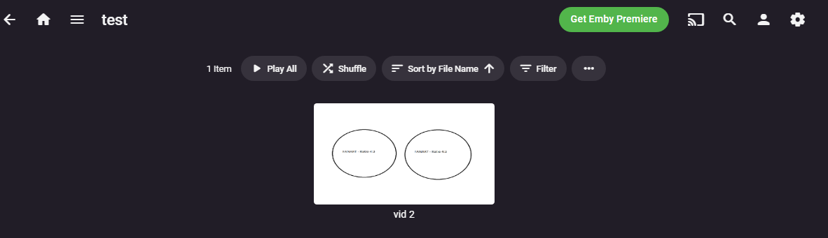

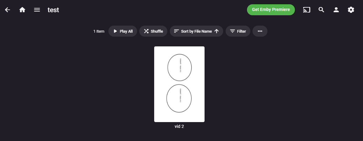

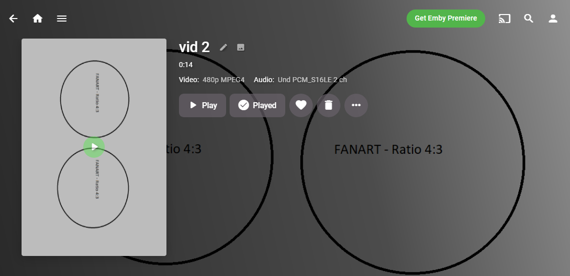

aikkie 1 Posted July 5, 2023 Author Posted July 5, 2023 See below, poster and fanart with 2 perfect circles being stretched in emby. folder content: Fanart in 4x3 ratio displaying 2 perfect circles poster in 3x4 ratio displaying 2 perfect circles Primary View Thumbnail View Video Listing View
Luke 42176 Posted July 5, 2023 Posted July 5, 2023 Ok this is normal. Thumb and fanart images should be 16:9.

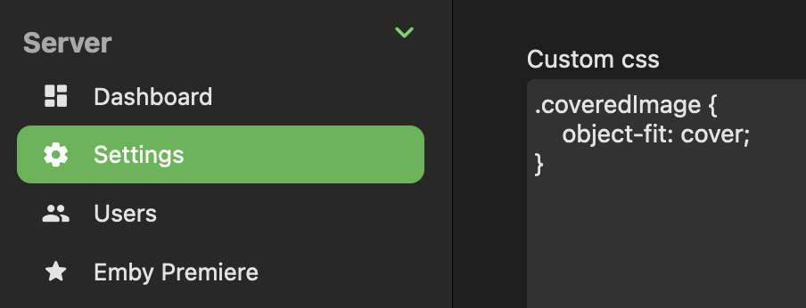

robbbin 1 Posted February 14, 2024 Posted February 14, 2024 Hey aikkie, I've been troubled by the same problem in last few month until I found the solution below. Add the following Custom css code in emby server settings, and save the changes. .coveredImage { object-fit: cover; } The emby server version I use is 4.8.1.0 I have tested it in browser's desktop mode and TV mode, all work fine. By the way, if you are fine with image crop, you can try using the Settings below, which will keep the 16:9 aspect ratio but without black border to the left and right. .coveredImage { object-fit: contain; } 1

aikkie 1 Posted February 17, 2024 Author Posted February 17, 2024 On 2/14/2024 at 6:36 PM, robbbin said: Hey aikkie, I've been troubled by the same problem in last few month until I found the solution below. Add the following Custom css code in emby server settings, and save the changes. .coveredImage { object-fit: cover; } The emby server version I use is 4.8.1.0 I have tested it in browser's desktop mode and TV mode, all work fine. By the way, if you are fine with image crop, you can try using the Settings below, which will keep the 16:9 aspect ratio but without black border to the left and right. .coveredImage { object-fit: contain; } This works perfectly! Thanks @robbbin! i chose "contain" in the end - would you happen to know if it's possible to change the border colour? the border was shaded with RGB (52,52,52), my intention is to change it to RGB(30,30,30) to match the background of the gallery so that the border is sorta invisbile. Thanks!

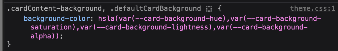

robbbin 1 Posted February 21, 2024 Posted February 21, 2024 @aikkie First, let me correct a mistake. I wrote the descriptions for the two examples in reverse. But seems you get the point. And for the question you asked On 17/02/2024 at 22:22, aikkie said: i chose "contain" in the end - would you happen to know if it's possible to change the border colour? the border was shaded with RGB (52,52,52), my intention is to change it to RGB(30,30,30) to match the background of the gallery so that the border is sorta invisbile. If you go to browser’s F12 inspector menu, and choose the element which contains the image, you will find it is defined as bellow So you can just add custom css to override it by using code bellow (Note: you need to use !important options to obtain higher priority) .cardContent-background { background-color: rgb(30, 30, 30) !important; } And like Luke said this may no longer work with the next version. Perhaps there might be better solutions, but here I'm just offering you an idea. On 15/02/2024 at 06:44, Luke said: I would suggest removing that custom css once you have the 4.8.2 maintenance release. An adjustment has already been made for this and you will no longer need it.
