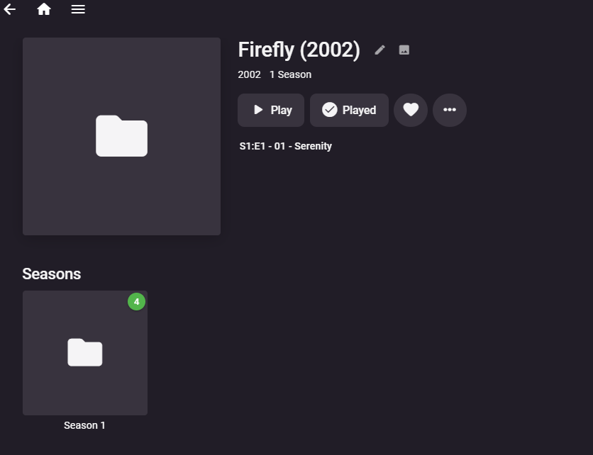

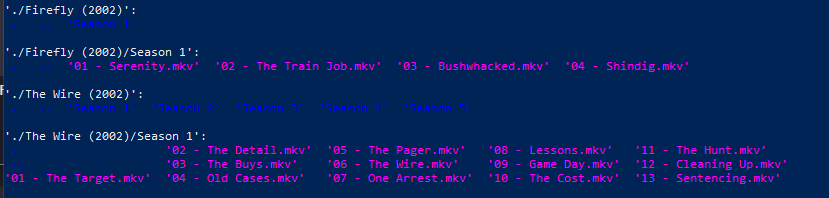

Zelbinian 4 Posted July 2, 2023 Posted July 2, 2023 I've added a few shows to the server now with no issues... until now. For some reason it doesn't like Firefly! Can anyone tell me what I'm doing wrong? Here is what I have done, in order I have named the show the same as I have others that Emby has processed correctly: {TV Folder}/Show Name (Year)/Season #/Ep - Title I attached a screenshot showing the folder/file name structure that also captures the files from another show that Emby correctly processed. I have also attached what the result is in Emby After it didn't upload automatically, I manually linked TheTVDB. When That didn't work, I also manually linked IMDb and a few others. I manually requested Emby refresh the metadata (including allowing it to replace pictures) I would attach a log but Emby did not seem to create one after I requested the metadata refresh.
