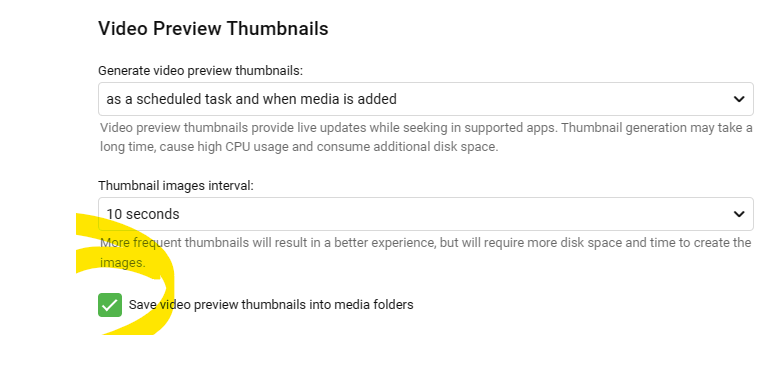

Ronstang 294 Posted July 3, 2023 Author Posted July 3, 2023 (edited) 5 minutes ago, ebr said: Above is correct but realize that BIF files are just a storage mechanism for the images (which may or may not continue to be used in the future and is not always used now). Then where are they stored? Being in the media folder makes the most sense so moving or deleting the folder takes the appropriate action. Or if they are still in the media folder....where? Edited July 3, 2023 by Ronstang
rbjtech 5335 Posted July 3, 2023 Posted July 3, 2023 13 minutes ago, Ronstang said: Then where are they stored? Being in the media folder makes the most sense so moving or deleting the folder takes the appropriate action. Or if they are still in the media folder....where? If you choose to .. this is a per library setting.
