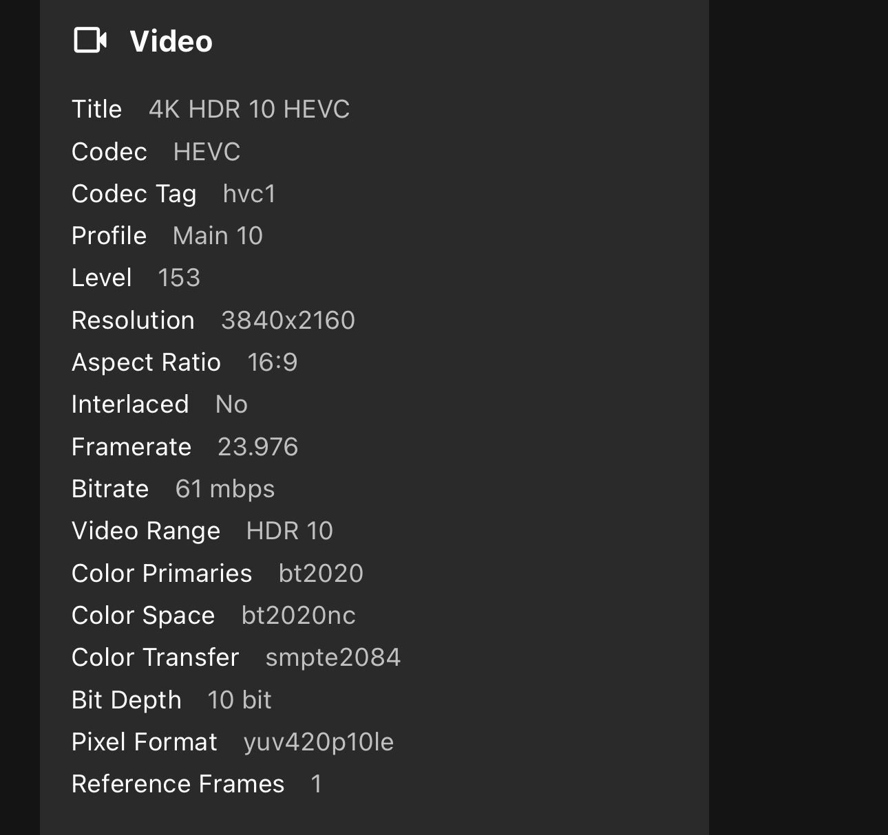

MrWGT13 24 Posted September 24, 2025 Posted September 24, 2025 On 9/12/2025 at 4:49 AM, Lazarus_Long said: Yep I know. I’ve been trying to get it into a correct format using ffmpeg and this is the latest test and it still won’t trigger. Not sure what else it could be? I did remove the audio track just to make sure it wasn’t causing any issues. It does show direct play with AVKIT as the renderer (not MPV) In my case the reason where external subtitles. Try to remove them and play again. I changed my workflow to internal subtitles which works on my side.
