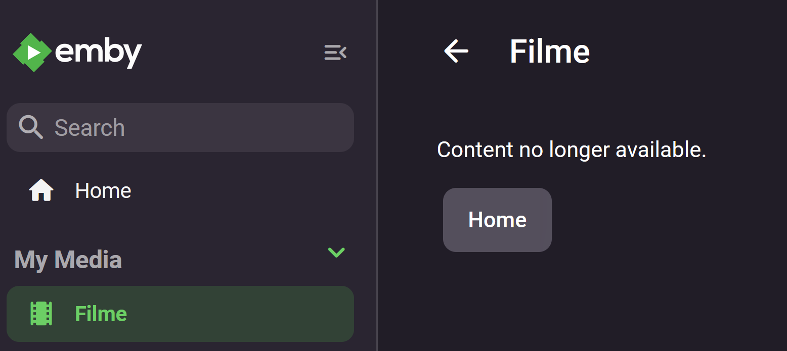

EmbyParty 14 Posted June 26, 2023 Posted June 26, 2023 I have a valid certificate A+ and a domain. Now I experience a strange issue. When I connect locally via http or https port I can play whatever movie I want. When I connect with the domain (locally or from extern) I can access all the libraries, but I cannot play any file. The error message is ether "content not available" or playback error. Any ideas what the issue could be?
Luke 42185 Posted June 26, 2023 Posted June 26, 2023 Hi there, let's look at an example. Please attach the information requested in how to report a media playback issue. Thanks!

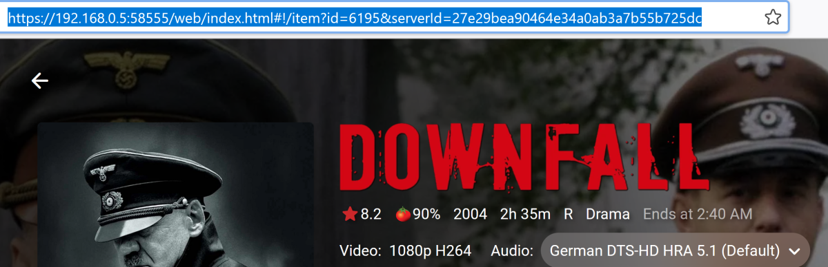

EmbyParty 14 Posted June 26, 2023 Author Posted June 26, 2023 (edited) sure: with https://mydomaine.com I get: It makes no difference wether I access from my local network or from outside with https://192.168.0.5(https port) the movie plays. . hardware_detection-63823412285.txt embyserver.txt Edited June 26, 2023 by EmbyParty
EmbyParty 14 Posted June 26, 2023 Author Posted June 26, 2023 This is with the local ip of the server, same movie.
