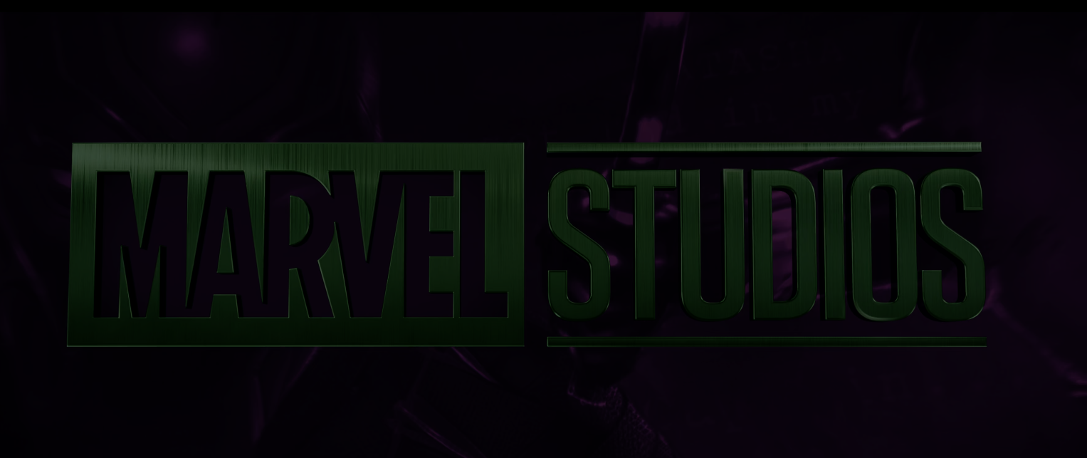

Bill4sman 10 Posted June 23, 2023 Posted June 23, 2023 (edited) Downloading some movies it seem the HDR settings are screwed up A Lot. This happens constantly when grabbing video from the web so what's going on? "Color space is not supported." Plex gives me this error while Emby will play the media but with messed up coloring. Edited June 23, 2023 by Bill4sman
Bill4sman 10 Posted June 23, 2023 Author Posted June 23, 2023 Dolby Vision is the problem it turns out...

Solution rbjtech 5345 Posted June 24, 2023 Solution Posted June 24, 2023 (edited) Simply put - you are using media that is designed for streaming with Dolby Vision (profile 5) ONLY. If you use media that is HDR10 only OR media that has both HDR10 and DV (Dolby Vision profile 8 ) then you won't have this issue .... I believe Emby will soon differentiate between the Dolby Vision profiles - thus giving you some extra information on why it is playing like it is. I know for a fact that the DV profile info is now collected and stored (in the latest beta at least) but I'm unsure when this will be presented to the client rather than just saying 'Dolby Vision' imo - dv5 - should say 'Dolby Vision Only' dv7 and dv8 - should say 'HDR10 / Dolby Vision' @softworkz @Luke Edited June 24, 2023 by rbjtech
