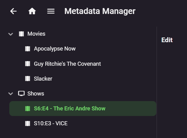

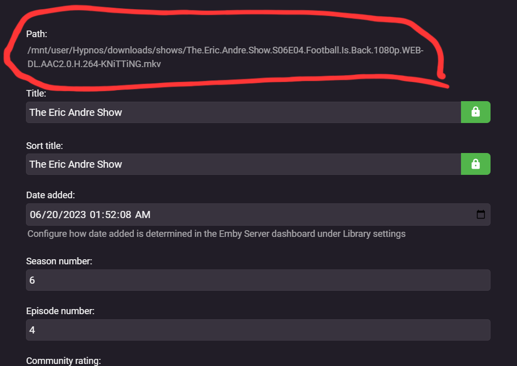

I just setup Emby and it's working great on Unraid with a sole exception: it's not loading metadata for TV shows. I have episodes going directly into a tv shows folder, where they are seemingly not picked up by Emby at all as shows (they appear only when looking at the folder view).
When I viewed them with the metadata manager, I added the show name and tried to refresh the missing metadata, but no dice. I have a few movies loaded and metadata works for those, just not the shows. I assume it's something simple, but I can't figure it out. Thanks for any help, a few images are attached which should illustrate.

Sorry, where do I find that? If I go to Edit Metadata, it has the season and episode number correct, but doesn't load the rest of the data. I manually added the show name and that didn't seem to do anything. Thanks for your help.

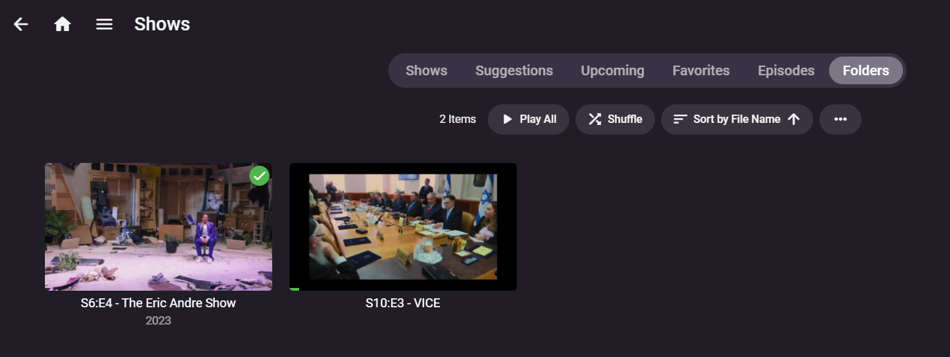

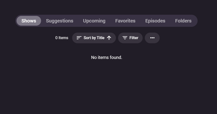

edit: I don't think it is picking up the shows at all actually, because if I go to Shows, it doesn't display anything. I can only see the files when viewing the Folder. Attached are some images to show what I mean.
And they will not be in that structure, each TV show needs its own folder, as per KB article:
https://emby.media/support/articles/TV-Naming.html
Having only episode files, as in your screenshot, won't do.
RexKwondo
That was my problem - thank you!

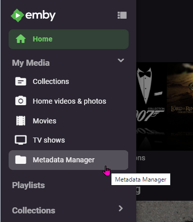

    1. Go to metadata manager:image.png.eb4586543abacee19f5ed89caea9d7b7.png

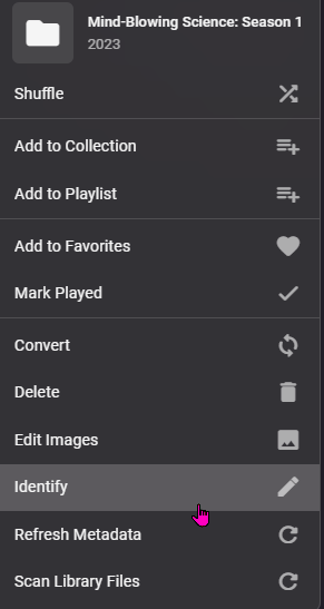

    3. Go to the upper right of the screen and click on the 3 lateral dots: image.png.7b74b1def8997a028f495ab397db5168.png
    4. Choose "Identify": image.png.4df9a667cc25823490346e351e9e12ee.png

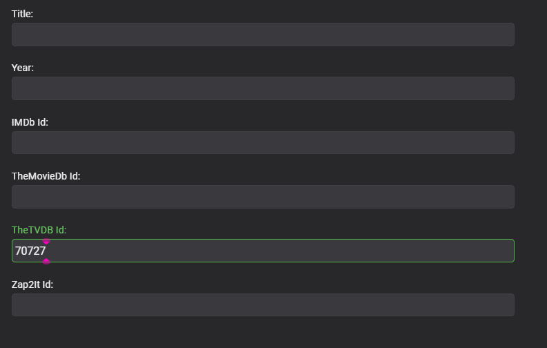

    5. On this screen is where you want to put the (for instance) TVDBID code: for Homicide Life on The Streets its 70727:image.png.b0036422fd42776359ed4b33e34dde48.png

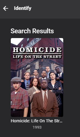

    6. hit Search
    8. (If it doesn't pull the right info, you put in the wrong code)
    9. Click on the picture to select the info:
