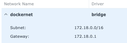

YvonLandry 2 Posted August 23, 2023 Posted August 23, 2023 (edited) the container subnet is 172.18.0.0 I added the subnet to emby then added the subnet to the firewall and still no go the log says that the Authentication request for admin has succeeded but Jellyseerr remain on the sign in page Edited August 23, 2023 by YvonLandry removed picture

YvonLandry 2 Posted August 23, 2023 Posted August 23, 2023 Sorry about this. this is what I'm trying to do, I have a DS720+ Synology NAS. I have Emby installed on the NAS as an application not in a container. I have installed Jellyseerr in a docker container using a bridge network emby and jellyseerr are being used locally only. hope this can help understand how I this setup

YvonLandry 2 Posted August 26, 2023 Posted August 26, 2023 Ok the problem has been resolved (almost). the main problem was caused by my browser (Safari), I used chrome and all started to work properly. I still had to add the network address 172.18.0.0/16 in emby under "LAN networks" to get every thing to work properly. Now I just need to figure out why safari is not working with jellyseerr. Thanks for all the help, really appreciated. 1
