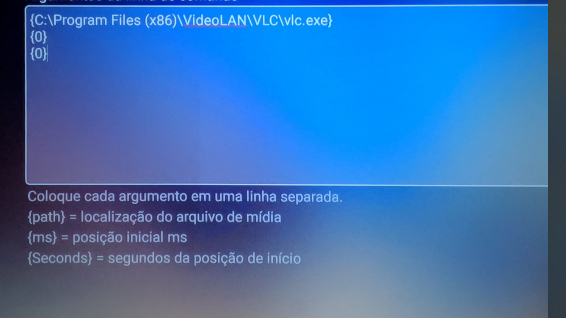

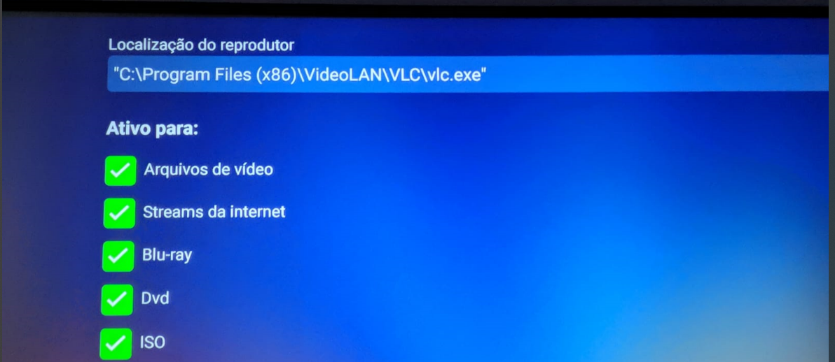

Franklynsbr2023 4 Posted June 25, 2023 Author Posted June 25, 2023 9 hours ago, RanmaCanada said: Yes you SHOULD be able to do 4k Remux as the video card does support 10bit HEVC encoding and decoding in hardware. Click on the professional tab and search for P400. It will show you what the card can do in hardware. I think your only limitation would be if your PC is powerful enough to decode the audio. You could also look at possibly getting a 4k MAX Firestick, though I am ignorant to as how expensive that would be in your country and I do apologize if it's stupidly so. The Firestick also does not play DTS-HD MA and TrueHD formats. "But I found out that the PC is running smoothly when I use the MPC player directly on this PC, without any issues. However, when the MPC is embedded within Emby, it freezes and the audio becomes out of sync. Could it be that I embedded the MPC incorrectly? Please take a look below and let me know if I did something foolish." Please provide the code or instructions you used to embed MPC within Emby so that I can review it and provide feedback. TY
Franklynsbr2023 4 Posted June 28, 2023 Author Posted June 28, 2023 On 6/25/2023 at 10:55 AM, Franklynsbr2023 said: The Firestick also does not play DTS-HD MA and TrueHD formats. "But I found out that the PC is running smoothly when I use the MPC player directly on this PC, without any issues. However, when the MPC is embedded within Emby, it freezes and the audio becomes out of sync. Could it be that I embedded the MPC incorrectly? Please take a look below and let me know if I did something foolish." Please provide the code or instructions you used to embed MPC within Emby so that I can review it and provide feedback. TY Any ideia? Please help me.
Luke 42237 Posted June 28, 2023 Posted June 28, 2023 1 hour ago, Franklynsbr2023 said: Any ideia? Please help me. Maybe just try the default {path} as the command line arguments. Did you research what command line arguments MPC supports? What did you find?
Franklynsbr2023 4 Posted June 28, 2023 Author Posted June 28, 2023 13 hours ago, Luke said: Maybe just try the default {path} as the command line arguments. Did you research what command line arguments MPC supports? What did you find? Filling in the command lines is exactly my doubt. I can look up the commands supported by MPC or VLC, but I wouldn't know how to fill them in Emby for Windows. For example, do I put the path in curly braces? And should ms and Seconds go inside or outside, or after the equal sign? I'm a beginner, and this filling is not clear to me. Is there any example of how to fill it in? Thank you in advance
Luke 42237 Posted June 28, 2023 Posted June 28, 2023 Nothing goes into curly braces expect for the tokens that are mentioned in the help text. As far as seconds before or after the equals sign, how does mpc want it? Start with the command line needed for mpc. You can just hardcode a video path. Then once you get that playing, then change the video path to {path}
