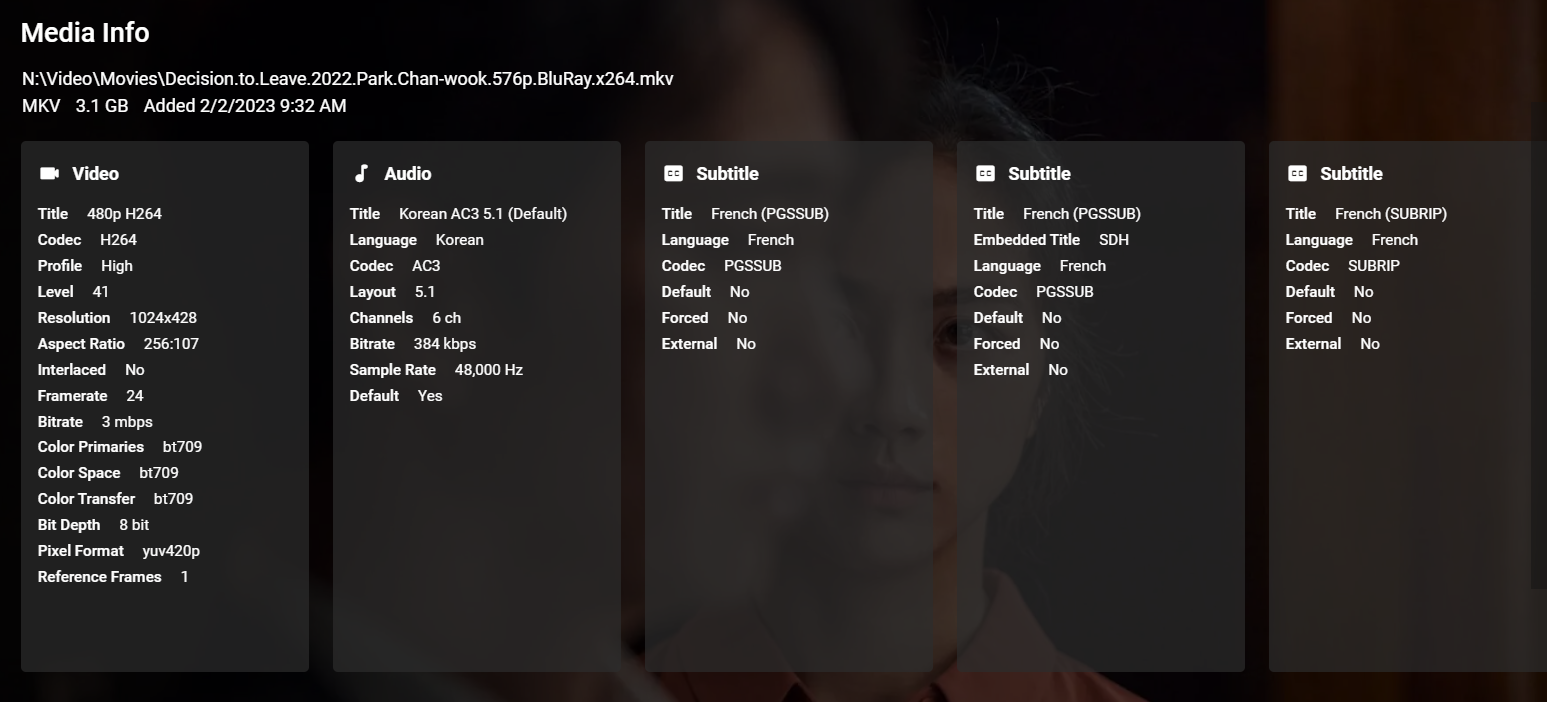

nospotify 187 Posted July 13, 2023 Author Posted July 13, 2023 Here are file details on two different files that still don't have proper playback control even after disabling audio transcoding: And here is a file that DOES play properly but only after disabling audio transcoding: 1
ebr 16352 Posted July 14, 2023 Posted July 14, 2023 17 hours ago, wordlover said: with multiple subtitle files If the item ends up needing to remux for any reason, the problem is going to re-occur. This is why I said originally that, even if we could work around this instance, it wasn't a true solution. The real problem is the way the files are constructed. Have you tried re-encoding one of them to see if that fixes the timing data?
