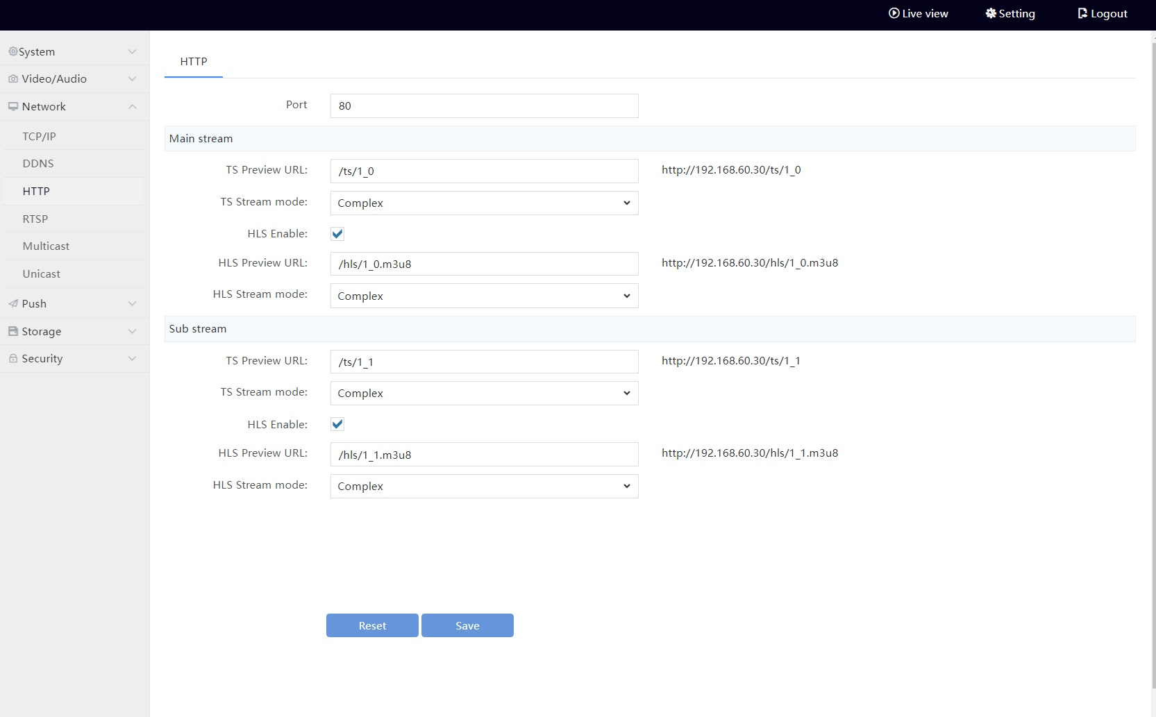

csadoian 36 Posted June 17, 2023 Posted June 17, 2023 I bought a cheap streaming box that I can send video into via HDMI and the box will output several types of streams, including TS & HLS using http or rtsp. At first I was using the IPTV plugin to view the stream, but I found that to be really unreliable and I could not record the stream in Emby, which is something I wanted to do. So I created a M3U tuner and have a simple file that points to the rtsp output of the streaming box. The m3u8 file basically looks like this: #EXTINF:-1 group-title="Local",Local Video rtsp://192.168.60.30/live/1_0 If there is no video being fed into the HDMI port the streaming box will output a static screen. Using VLC I can see this screen just fine. Using Emby it just spins and spins, black screen. Once I start some video going into the box Emby can pick it up and play the stream, but at times it seems to just freeze up or abruptly stop. Using VLC this does not happen. The stream on VLC is steady and never drops. I did a comparison test and will upload the resulting logs. The ffmpeg log with f562 at the beginning is Emby attempting to decode the stream that is the "placeholder" screen (i.e. just a static jpg image being output by the box). The other ffmpeg log is Emby successfully decoding the stream after I connected HDMI video to the streaming box (my laptop's desktop screen). By looking at these logs can you tell me why Emby has a problem with the "static picture" stream as compared to the stream of an actual video signal going into the box? I'm thinking that if I knew what Emby (or ffmpeg) doesn't like about the static stream it might help me figure out how to make the stream more reliable and less prone to dropping the video (or freezing up). I'd tend to blame it on my cheap streaming box, but VLC seems to handle the stream just fine. embyserver.txt ffmpeg-directstream-6e23ab44-fa9e-463a-8999-fd4a8aebd960_1.txt ffmpeg-directstream-f5626514-de00-47fd-ae7c-aa99a9d14780_1.txt

Luke 42185 Posted June 26, 2023 Posted June 26, 2023 Is rtsp the only option? Does the source have an http output option?
csadoian 36 Posted June 26, 2023 Author Posted June 26, 2023 (edited) 3 hours ago, Luke said: Is rtsp the only option? Does the source have an http output option? @LukeIt has several options, but I've tried both the http and rtsp (both low and high resolution) but they both act the same. The rtsp option seems to be the most stable. Did you guys make a change that would affect the m3u tuner? Reason I ask is that, after you asked me the question about http I went to emby and tried to edit the m3u tuner I already had defined and nothing happens when I click on edit. Tried Emby for Windows and the web client. So I deleted the tuner and attempted to add a TV source, selected M3u and nothing happens. If I select HD Homerun the dialog for that comes up. What happened to prevent me from adding/editing my m3u tuner? Do you need a server log? Edit: Ok, so it works when I go to the actual server and do the configuration there. I could have sworn I was able to add/edit a m3u tuner from any one of my client machines on the same network, but I guess I was wrong. I don't often log directly into my actual Emby server since it operates headless and I have to use Remote Desktop to access it. Edited June 26, 2023 by csadoian
