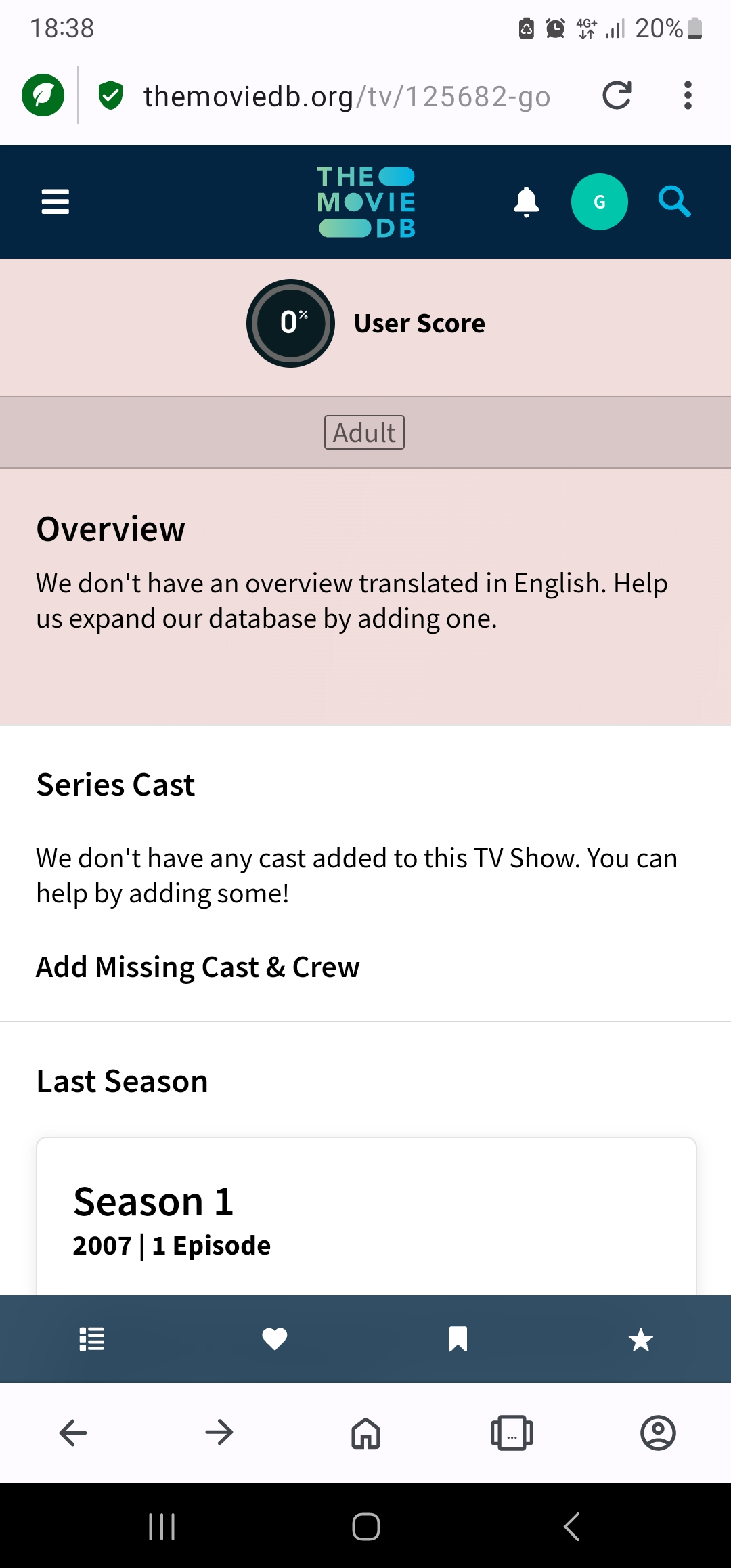

GrimReaper 4845 Posted June 16, 2023 Posted June 16, 2023 (edited) Likely because there isn't any available, both Overview and Cast (and majority of other metadata) is null. https://api.themoviedb.org/3/tv/125682?api_key=f6bd687ffa63cd282b6ff2c6877f2669&append_to_response=alternative_titles,reviews,casts,releases,images,keywords,trailers&language=en Edited June 16, 2023 by GrimReaper

MasterTooTwo 0 Posted June 21, 2023 Author Posted June 21, 2023 On 6/16/2023 at 12:42 PM, GrimReaper said: Likely because there isn't any available, both Overview and Cast (and majority of other metadata) is null. https://api.themoviedb.org/3/tv/125682?api_key=f6bd687ffa63cd282b6ff2c6877f2669&append_to_response=alternative_titles,reviews,casts,releases,images,keywords,trailers&language=en I see. But if there is no Overview and Cast info for certain movie, should it be empty after updating it instead of keeping the previous metadata?
seanbuff 1353 Posted June 21, 2023 Posted June 21, 2023 49 minutes ago, MasterTooTwo said: But if there is no Overview and Cast info for certain movie, should it be empty after updating it instead of keeping the previous metadata? Yes, there used to be an old bug that would not remove the previous metadata before applying the new ones, that since changed but perhaps is not completely working if there is no new data to replace it. IMO all previous data should be zeroed out before applying newly identified metadata. Perhaps this has been reworked in 4.8 with the introduction of the new 'Remove Identification' feature? @Luke
