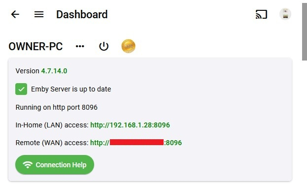

monnieharden 0 Posted September 13, 2023 Author Posted September 13, 2023 (edited) i installed pia access vpn and still cannot remotely access my emby server Edited September 13, 2023 by GrimReaper WAN IP hidden
GrimReaper 4927 Posted September 13, 2023 Posted September 13, 2023 (edited) 19 minutes ago, monnieharden said: i installed pia access vpn and still cannot remotely access my emby server Did you setup Port forwarding, else you won't be able to connect? Also, have a read here for few alternative solutions: Edited September 13, 2023 by GrimReaper
