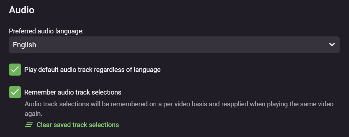

seanbuff 1360 Posted June 15, 2023 Posted June 15, 2023 17 minutes ago, Gene_Starwind said: Is there a way to set all playback to a specific default language, or do I have to do it with every single file, manually? You can use your User 'Playback' settings to control this behaviour. 1

Gene_Starwind 4 Posted June 15, 2023 Author Posted June 15, 2023 2 hours ago, seanbuff said: You can use your User 'Playback' settings to control this behaviour. OK, I've tried that, but it won't stick. When it says "Play default audio", does that mean the file's primary audio track? If so, that may be the problem. I have lots of files that have JPN and ENG, with JPN as the primary.
seanbuff 1360 Posted June 15, 2023 Posted June 15, 2023 3 minutes ago, Gene_Starwind said: When it says "Play default audio", does that mean the file's primary audio track? Yes that's exactly what it means. You can try unchecking that option and see if that gives you a better result. In theory it should always choose the ENG track if that is your "preferred audio language" 1
Gene_Starwind 4 Posted June 15, 2023 Author Posted June 15, 2023 2 minutes ago, seanbuff said: Yes that's exactly what it means. You can try unchecking that option and see if that gives you a better result. In theory it should always choose the ENG track if that is your "preferred audio language" I'll give it a try. Thanks. 1
pwhodges 2039 Posted June 15, 2023 Posted June 15, 2023 2 hours ago, Gene_Starwind said: When it says "Play default audio", does that mean the file's primary audio track? In an MKV file (not sure about MP4) the streams have a flag which can mark them as default. In this case is is quite possible for the second stream to be the one marked default. As I understand it, Emby will use that flag if told to play the default track. Paul

Gene_Starwind 4 Posted June 18, 2023 Author Posted June 18, 2023 On 6/15/2023 at 9:11 AM, seanbuff said: Yes that's exactly what it means. You can try unchecking that option and see if that gives you a better result. In theory it should always choose the ENG track if that is your "preferred audio language" I tried it. It works, so far. Thanks. 1 1
