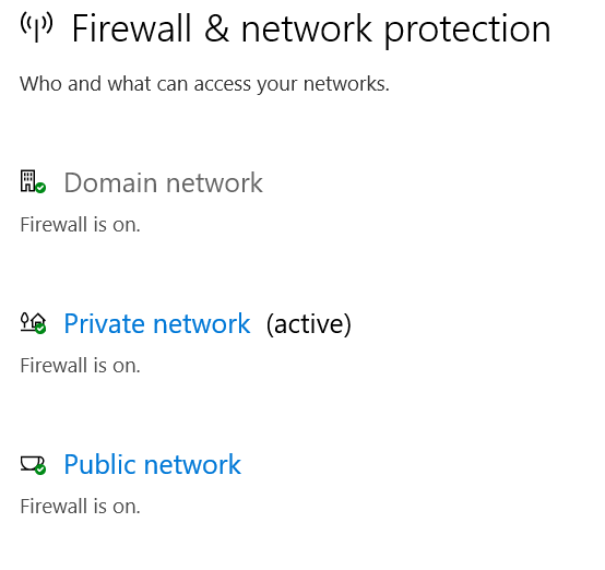

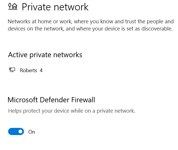

zape 2 Posted June 15, 2023 Author Posted June 15, 2023 Yes, I'm on private... a couple of screenshots attached showing no active public connections, and the details under private. The only thing that I can tell changed was the new patches applied by Microsoft at the time it started failing.
