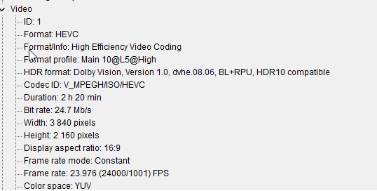

softworkz 5133 Posted June 27, 2023 Posted June 27, 2023 Can you try to move the CUVID HEVC decoder to the top of the list (don't forget Save) and retry? Is this a Dolby Vision format? ffmpeg detects it as SDR yuv420p (not HDR). Can you show an ffmpeg log with software transcoding?

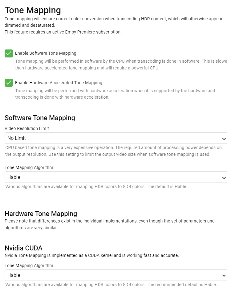

softworkz 5133 Posted June 28, 2023 Posted June 28, 2023 The problem here is tone mapping. Software tone mapping is expensive, especially when on 4k frames without downscaling. What's additionally expensive is transferring 4k frames from GPU memory to system memory, because those frames are uncompressed (about 120MB per 4k frame). This is what happens in case when the CUVID decoder is chosen, and that why this is much slower. In the case where you chose the NVDEC Emby had an optimization to do software decoding because it's better in this case, so there was no HW involved at all in this case. --- You did not include a log with NVENC enabled. Ideally, it should perform everything in hardware: decoding, tone mapping and encoding, so we'd need to find out why this doesn't work. Please make sure you have hardware tone mapping enabled as well as the NVENC encoder. Thanks PS: We do not use x265 for streaming, only for the conversion feature. You will find the reasoning in all detail elsewhere here in the forums.

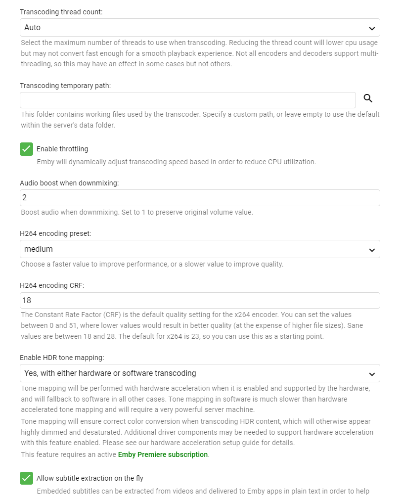

nodiaque 62 Posted June 28, 2023 Author Posted June 28, 2023 (edited) OK, I've redone my test. One thing to note, it doesn't happen with all x265 file, which is another weird thing. Video 4k no hdr no dv, there's subtitle in MOV format (might be the issue, it's Embedded subtitles?). Video 4k dv + hdr profile, subtitles SRT embedded 4k dv hdr10 - NVDEC NVENC - crash and stop 4k dv hdr10 - CUVID NVENC - crash and stop (video stop playing but logfile show it's still transcoding but video doesn't play need to refresh browser) 4k dv hdr10 - NVDEC software - all good (log files says no tone mapping but it's enable with the option either hardware or software, so why no tone mapping?) 4k dv hdr10 - CUVID software - lag playback 4k dv hdr10 - Software Software - no problem 4k no dv, no hdr - NVDEC NVENC - crash after a while or lag and will crash on seek 4k no dv, no hdr - CUVID NVENC - no problem 4k no dv, no hdr - NVDEC software - no problem 4k no dv, no hdr - CUVID software - no problem 4K no dv, no hdr - Software software - no problem 4k no dv no hdr - CUVID-Software.txt 4k no dv no hdr - movie info.txt 4k no dv no hdr - NVDEC-NVENC.txt 4k no dv no hdr - NVDEC-Software.txt 4k no dv no hdr - Software-Software.txt 4d dv hdr - NVDEC-NVENC.txt 4k dv hdr - CUVID-NVENC.txt 4k dv hdr - movie info.txt 4k dv hdr - NVDEC-Software.txt 4k dv hdr - Software-Software.txt 4k no db no hdr - CUVID-NVENC.txt Edited June 28, 2023 by nodiaque anonymise files
nodiaque 62 Posted June 28, 2023 Author Posted June 28, 2023 oh, just saw when I posted you replied something. Tell me if you want me to still do the other test plugin you ask. For information, these are my current transcoding setting in both Transcoding and Advanced Transcoding

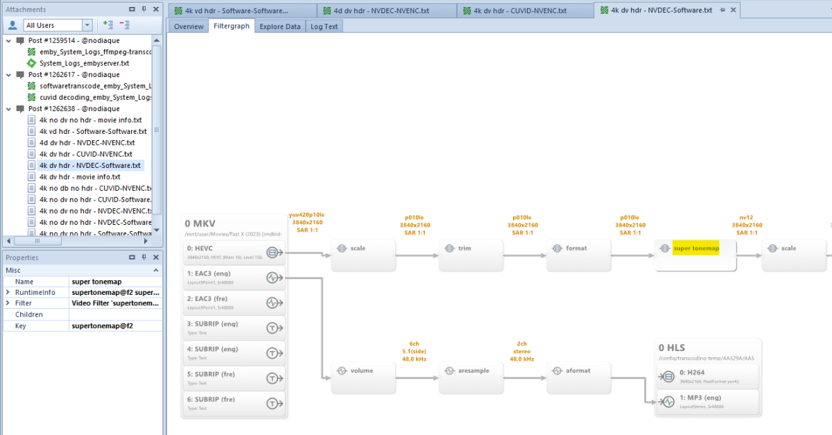

softworkz 5133 Posted June 28, 2023 Posted June 28, 2023 Ok, let's drill this down - looking at the HDR10 movie first: 16 minutes ago, nodiaque said: 4k dv hdr10 - NVDEC NVENC - crash and stop 4k dv hdr10 - CUVID NVENC - crash and stop (video stop playing but logfile show it's still transcoding but video doesn't play need to refresh browser) From the transcoding side, it's all perfect. No crash, no stop. Decent performance (> 5x). 16 minutes ago, nodiaque said: 4k dv hdr10 - NVDEC software - all good (log files says no tone mapping but it's enable with the option either hardware or software, so why no tone mapping?) 4k dv hdr10 - Software Software - no problem Both cases are identical. (Like I explained above, it doesn't use hw decoding because it would be worse - see the case with cuvid decoding) But sw tone mapping is being used: 16 minutes ago, nodiaque said: 4k dv hdr10 - CUVID software - lag playback Yes, like explained above.
softworkz 5133 Posted June 28, 2023 Posted June 28, 2023 As for why it doesn't play in the browser: This is most likely due to the bitrate. We had some calculation in place that sets the double input bitrate for the output when transcoding from h265 to h264 (changed in the beta channel). In your example, this is 25 Mbps to 50 Mbps and that's usually too much for browser playback. SW transcoding works because it doesn't "obey" those parameters and usually produces lower bitrates. Please try changing the quality setting from auto to some lower bitrate, I'm sure it will play then.
