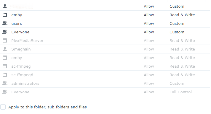

Smeghain 14 Posted September 25, 2024 Posted September 25, 2024 Anyone be able to help me that`d be great : I tried to install jellyfin in a docker container, but i didnt know they shared the same port number long story short it didnt work so i removed Jellyfin and tried to fire back up Emby, it kept trying to load Jellyfin, I foolishy decided to uninstall Emby and try and reinstall it after I found a link just saying to remove the cache files in the browser, anyway now I reinstalled Emby but when I try and add the folders back in i keep getting "There was an error adding the media path. Please ensure the path is valid and the Emby Server process has access to that location." someone suggested removing the @appdata/EmbyServer from the file system but when I tried to do that it says "I Dont have permission" Can someone help me please ?.

Neminem 1623 Posted September 26, 2024 Posted September 26, 2024 Dev's will need logs. But this sounds like permissions issues.
Smeghain 14 Posted September 26, 2024 Posted September 26, 2024 1 hour ago, Smeghain said: I tried to shut down and the in re-installed Emby but im still getting the error, When I load up Emby its still showing the catagories of Tv Shows Movies and so on (that ive added) but there is no content inside the catagories. There was an error adding the media path. Please ensure the path is valid and the Emby Server process has access to that location. Im pretty sure the permissions are all ok (Im probably wrong though since the error) im starting to wonder if the only solution is to either delete @appdata/EmbyServer if theres another way around this i`d be really greatful if you could work it out for me.
Smeghain 14 Posted September 26, 2024 Posted September 26, 2024 15 hours ago, Luke said: Hi, can you reboot the nas and try again? Hey, Just an update on the situation, I removed emby server from the NAS, I then re-installed it and then updated it to the latest beta version and the issue I had seems to have been fixed. Not sure how or why....but I'll take it...just in case anyone else runs in to this issue. Thanks for the help and suggests folks.... 1 1
