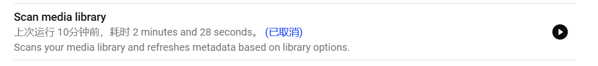

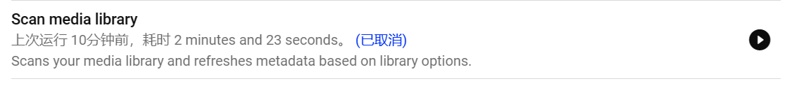

DC6264 0 Posted June 11, 2023 Author Posted June 11, 2023 embyserver.txtembyserver.txtThe Scan process could never finish and will shows canceled as result Which means my update could never showed in database. Please help to check out, thanks.

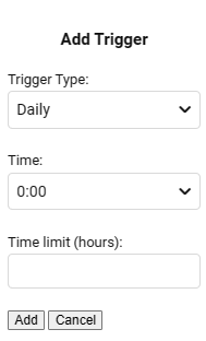

rbjtech 5335 Posted June 13, 2023 Posted June 13, 2023 On 12/06/2023 at 09:34, DC6264 said: Can't figure it our why this task will cancelled automatically embyserver (1).txt 126.55 kB · 3 downloads Do you maybe have something set in the Time limit on the schedule ? Probably worth deleting it and creating a new one to rule it out .
DC6264 0 Posted June 13, 2023 Author Posted June 13, 2023 Thanks for your advise, but the problem stay still no matter i delete it all or create a new one

Luke 42185 Posted June 13, 2023 Posted June 13, 2023 5 hours ago, DC6264 said: Thanks for your advise, but the problem stay still no matter i delete it all or create a new one HI, you must have set a time limit for the library scan just as rbjtech mentioned. Click on the Scan media library scheduled task. What does it show there for the task schedule?

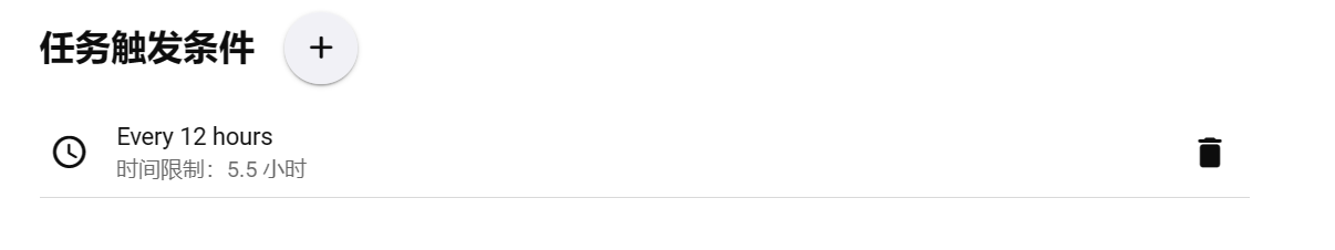

DC6264 0 Posted June 14, 2023 Author Posted June 14, 2023 No matter delete all scheduled task or create a new on and limit to 5.5 hours, it will still cancel this task after 2 minutes. I did not adjust any scheduled task before. embyserver (2).txt

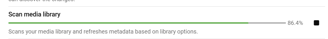

DC6264 0 Posted June 18, 2023 Author Posted June 18, 2023 The Problem is stay still even i install with docker version. It is really killing me that movie could update now but TV show still do not update. I could not know is it the system scaning or not.
