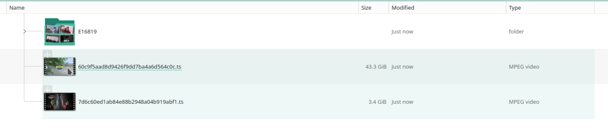

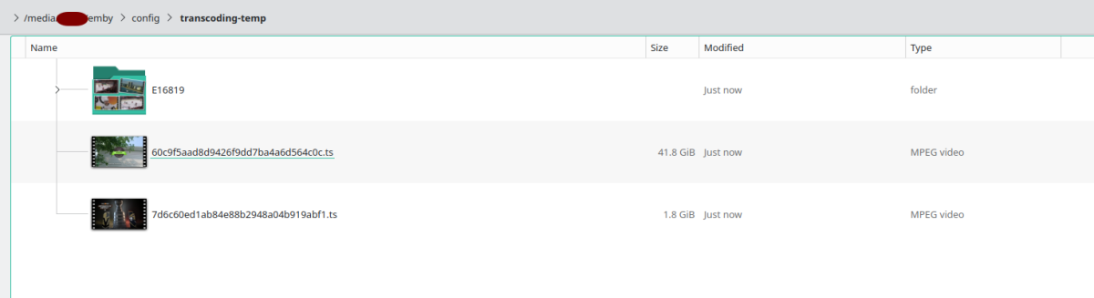

Eddie 12 Posted June 9, 2023 Posted June 9, 2023 (edited) I have a freshly installed emby container running inside of docker Docker version 23.0.4, build f480fb1e37 OS: Manjaro 22.1.3 Talos Kernel: x86_64 Linux 6.2.16-1-MANJARO Emby Server Version 4.7.13.0 There is a single file inside of emby/config/transcoding-temp/ called 60c9f5aad8d9426f9dd7ba4a6d564c0c.ts and it continues to grow in size for the last couple days, its at 40 gigs right now and growing Is there a normal purge that happens every day or so? Edited June 9, 2023 by Eddie

Eddie 12 Posted June 9, 2023 Author Posted June 9, 2023 sorry i was just trying to make the name shorter but the actual name is 60c9f5aad8d9426f9dd7ba4a6d564c0c.ts and its 41.8 Gigs now

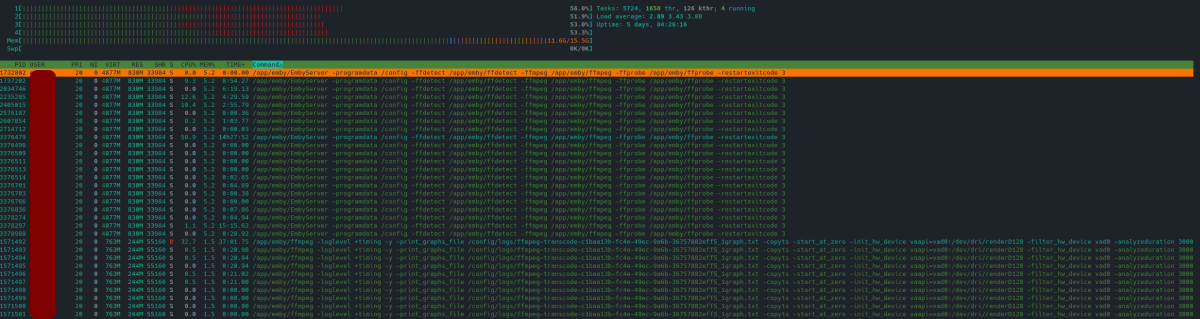

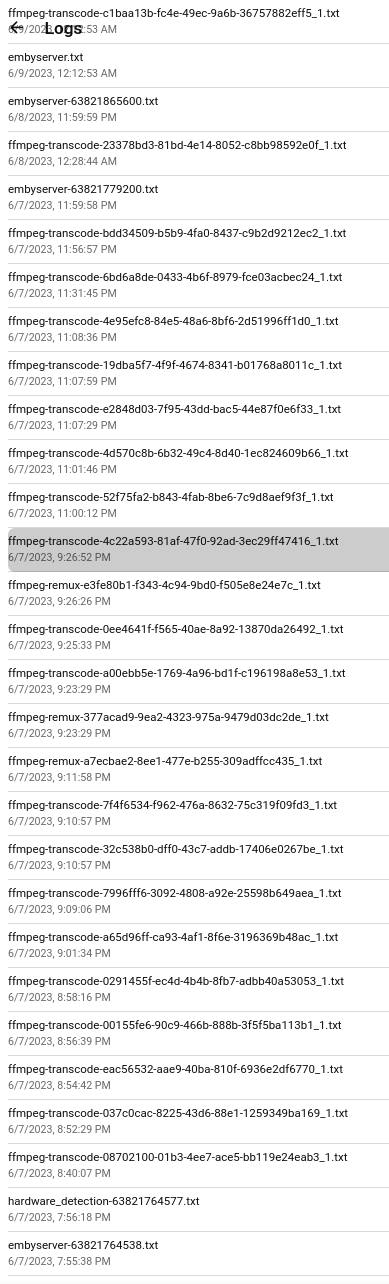

Eddie 12 Posted June 9, 2023 Author Posted June 9, 2023 (edited) I have a lot more logs in my log section and this is all i found in htop im not that good with htop but i did sort by > command and searched for ffmpeg but thats all i found Ill restart the server tomorrow in the am and let you know if anything has changed I have terrabytes of space so we will see what its like in the am but its still growing Edited June 9, 2023 by Eddie
softworkz 5133 Posted June 9, 2023 Posted June 9, 2023 5 minutes ago, Eddie said: and this is all i found in htop im not that good with htop but i did sort by > command and searched for ffmpeg but thats all i found Well, I can see a lot of ffmpeg processes there, one is consuming CPU cycles. Can't you restart right now?
