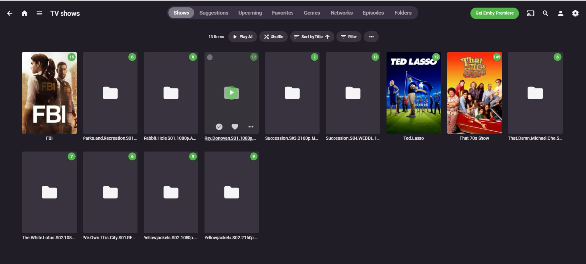

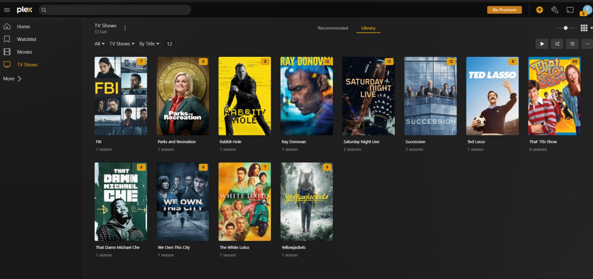

tzubairi 0 Posted June 7, 2023 Posted June 7, 2023 Hi, I'm a new Emby user. Trying to see if it's better than Plex which I've used for many years. I'm having issues with Emby file indexing and Metadata that I don't have with Plex. My files are being sourced from the same movie & TV show folders in Plex and Emby, so the file /folder structure is the same some folders are even poorly named like That.Damn.Michael.Che.S02.1080p.HMAX.WEBRip.DD5.1.x264-KOGi[rartv] but Plex can clearly figure it out.. In Plex a TV show, for example, Succession is all showing up together even though there are different folders for seasons in the source files and then when I open the show the seasons are separate as they should be, and it's pulling the correct metadata (pictures, descriptions, etc.). I don't need to modify anything. Works perfectly. In Emby it's not pulling the metadata for most TV shows and the seasons for shows are not grouped together. For the few it has been done correctly, I had to manually change the metadata details. Does anyone know a fix? I want to switch to Emby but if I have to index manually I'll stick to Plex. I've attached Plex and Emby screenshots for reference. Thanks

pwhodges 2023 Posted June 7, 2023 Posted June 7, 2023 Emby cares more about folder structure, I think is the main difference. As Emby prefers a relatively clean structure, a layout that works in Emby will, I believe) also work in Plex. I would recommend as a start simply gathering the folders of separate seasons of a single series into a folder named for just the series itself. Emby will probably be able to figure out the seasons from the naming you already have. If it still fails, then maybe just renaming the season folders will then make the difference. For my part, I always ensure that the actual videos include s01e01 etc explicitly in their names, to eliminate possible ambiguities. https://emby.media/support/articles/TV-Naming.html If renaming of video files is still necessary, then a bulk renamer is a good move, either something like Bulk Rename Utility (which is how I do it) or one of the programs which rename media files according to clear rules such as FileBot. Paul
