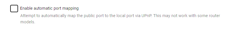

ebr 16307 Posted June 6, 2023 Posted June 6, 2023 37 minutes ago, Matt_Noel said: is there a resource that tells me how to do that? Server Settings Also please turn off automatic port mapping in the network settings. That is failing and spamming your log with errors. Finally, turn on debug logging under the Logs section and post a log after the issue occurs again. Thanks.

Carlo 4561 Posted June 6, 2023 Posted June 6, 2023 Lots of spammed error messages in the log making it hard to read. Go into Network menu and turn off Enable automatic port mapping You can uninstall the port mapper plugin as well. Restart Emby and your logs will be much easier to read after that. Carlo
