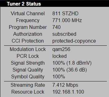

Deihmos 170 Posted August 17, 2015 Posted August 17, 2015 (edited) @@krustyreturns I have several channels that are copyonce. For example all the movie channels from 811 - 826 are copy once except 817. I know they are copyonce because they are indicated as copyonce on the hdhomerun and kodi cannot play them. Edited August 17, 2015 by Deihmos

Deihmos 170 Posted August 17, 2015 Posted August 17, 2015 It turns out I need to run a channel scan in the hdhomerun setup for the list to generate. I am not sure why because the hdhomerun app has all the channels that I subscribe to listed and correctly marked as copyonce. It is now working and the copyonce channels are excluded. Thanks.
