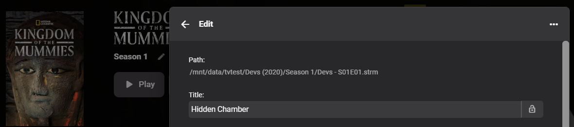

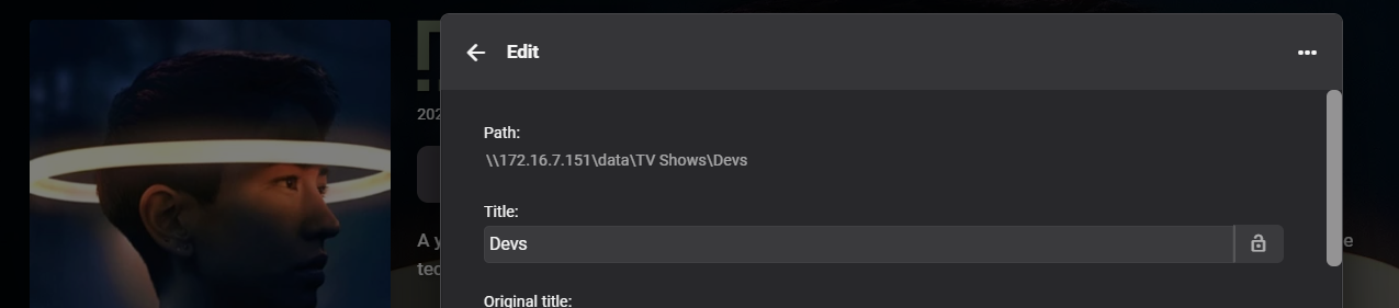

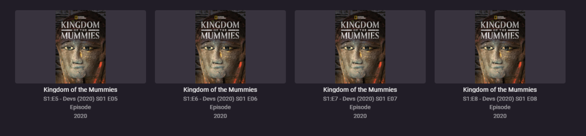

bruor 43 Posted June 2, 2023 Posted June 2, 2023 Hoping someone out there can help me figure out why media isn't scanned correctly in some instances. My TV library is setup to use TheTVDB to identify series. The TV folder you see in the screenshot is the root of the library. When emby scans them, the media is identified as "kingdom of the mummies" I have to manually correct this by going to identify, typing "devs" into the title field and clicking search. When I do this, the correct show is the 1st result, and Kingdom of the Mummies isn't shown in the results.

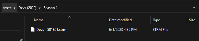

darkassassin07 671 Posted June 2, 2023 Posted June 2, 2023 From embys naming guide: https://emby.media/support/articles/TV-Naming.html Try putting the episodes in a 'season x' folder inside the series folder, and remove the year from the episode file names (only put the year in the series folder name)
bruor 43 Posted June 2, 2023 Author Posted June 2, 2023 I created a copy of the files in a secondary location with the updated names and it did not correct the issue. But, removing the year from the folder name of the show worked....

darkassassin07 671 Posted June 2, 2023 Posted June 2, 2023 (edited) If I take a random video file, rename it to 'Devs - S01E01.avi' and put it in 'Tv Shows/Devs (2020)/Season 1/' emby identifies it perfectly. Follow the instructions you've been given. Ie, the naming conventions in the link I provided. Edited June 2, 2023 by darkassassin07

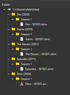

bruor 43 Posted June 2, 2023 Author Posted June 2, 2023 There are only a few more cases where this is happening, I've verified for them all that the correct show exists in TheTVDB. If I search the series folder name on the identify screen the 1st result is the correct one. Series folder name Misidentified as The Nevers (2021) Never Mind the Buzzcocks (2021) Episodes (2011) Tai Chi Chasers Traces (2019) The Wall

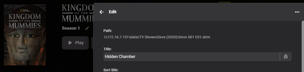

roaku 842 Posted June 2, 2023 Posted June 2, 2023 (edited) 6 minutes ago, bruor said: I think I've been pretty clear that I'm doing exactly what you recommended and it is not working on this end. Can you please re-read what I said I've tried and let me know where you think I've done something incorrectly? I've never seen an example with a space between the season number and the episode number like you have. What happens when you try 'S01E01' instead of 'S01 E01' *and* make sure you have the year in both the parent folder name and the episode names so that they properly match each other? Edited June 2, 2023 by roaku

roaku 842 Posted June 2, 2023 Posted June 2, 2023 Just now, seanbuff said: Yes, but at that point, they no longer had matching folder and file names.

bruor 43 Posted June 2, 2023 Author Posted June 2, 2023 darkassassin07 specifically told me to keep the year on the folder and not on the file name. I deleted my test library, re-created a tv show library using default settings, pointed it at a new test folder on my NAS. I created a test case for all series that are being incorrectly identified with exactly the folder and naming structure suggested by darkassassin07 All series are still mis-identified.

bruor 43 Posted June 2, 2023 Author Posted June 2, 2023 I made the change to the test library to put TheMovieDB as the 1st metadata provider and got better results, 4/5 of the problem series were identified properly. However, now the show "Des (2020)" is being identified as "100% Wolf: The Legend of the Moonstone"

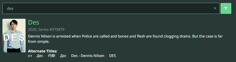

bruor 43 Posted June 2, 2023 Author Posted June 2, 2023 I've tried about 20 other searches for TV series name with year in the search string and they come back empty. However, If I search for the series name (Des or Devs) with year in brackets, this URL is used: https://thetvdb.com/search?query=des (2020) Results are: If I search for the series name, and filter for the year, it uses this URL: https://thetvdb.com/search?query=des&menu[year]=2020 Correct result is shown Perhaps the TVDB scraper is searching for the folder name as a string, and falling back to another method if no result is found? I'll try to scan my library with TMDB as the primary provider and see what results I get.
Luke 42185 Posted June 4, 2023 Posted June 4, 2023 On 6/2/2023 at 9:23 AM, bruor said: I've tried about 20 other searches for TV series name with year in the search string and they come back empty. However, If I search for the series name (Des or Devs) with year in brackets, this URL is used: https://thetvdb.com/search?query=des (2020) Results are: If I search for the series name, and filter for the year, it uses this URL: https://thetvdb.com/search?query=des&menu[year]=2020 Correct result is shown Perhaps the TVDB scraper is searching for the folder name as a string, and falling back to another method if no result is found? I'll try to scan my library with TMDB as the primary provider and see what results I get. Can you please provide the server log from when the search took place? Thanks.
