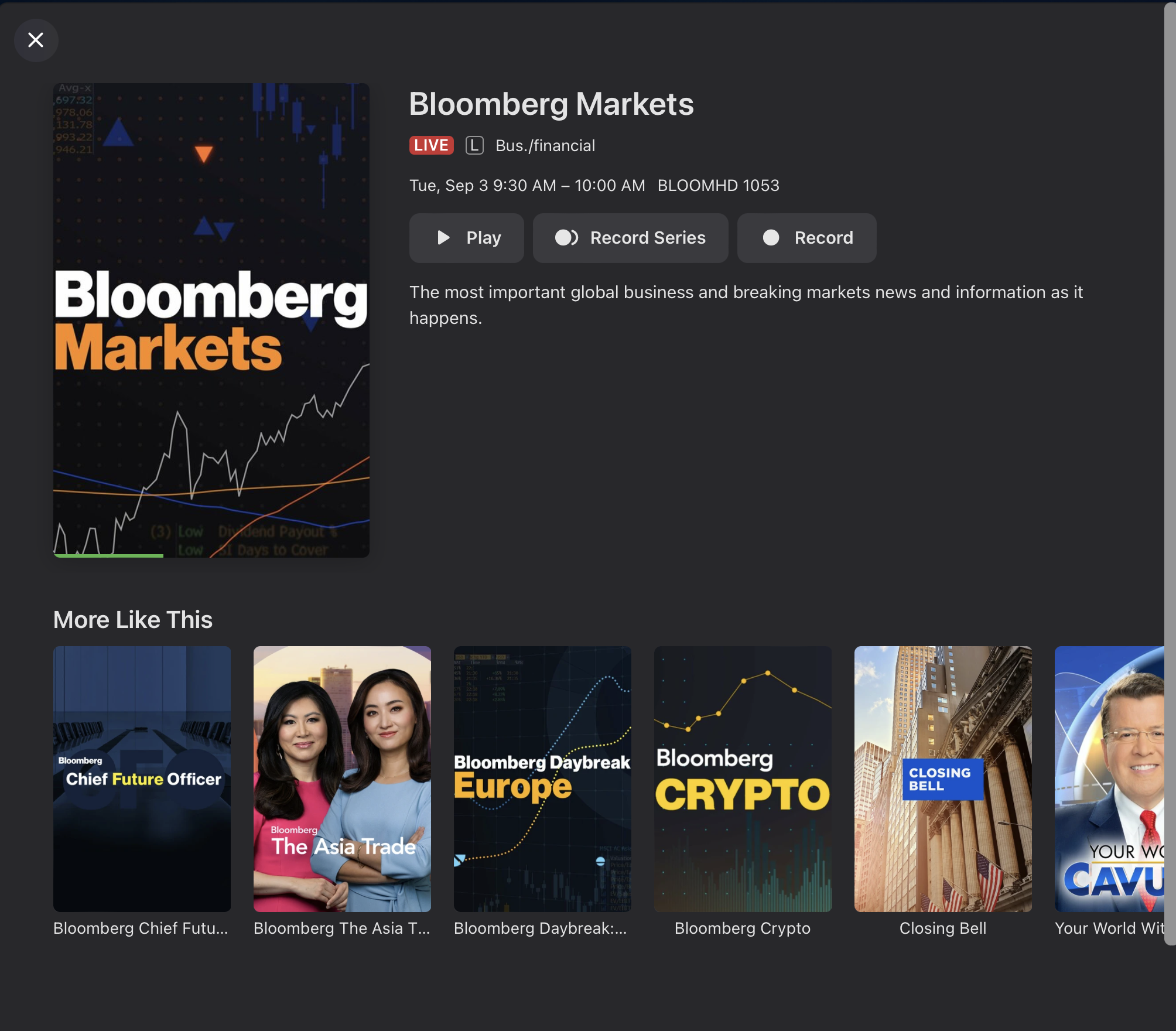

zaHrecsohbiw 14 Posted September 3, 2024 Posted September 3, 2024 On 8/31/2024 at 3:58 PM, ebr said: Hi. Example? This is obviously very thorough and has a lot of useful metadata. I just find it curious that it does _not_ include US ratings in this case. (Note: it at least makes sense that for this example, the displayed rating is wrong in the guide. It makes less sense in the aforementioned examples where US ratings _are_ available but still not displayed.) It seems like the intention in the GUI is to also display all provided qualifiers and genres? Perhaps not. I swear I've seen at least two qualifiers listed at once before, but I could be misremembering. I don't know if you have a way of prioritizing the most relevant qualifiers and omitting the ones that don't matter, or if they manage some other logic, etc. { "startTime": "2024-09-03T16:30Z", "endTime": "2024-09-03T17:00Z", "duration": 30, "qualifiers": [ "CC", "HD 1080i", "HDTV", "Live", "New" ], "channels": [ "353" ], "program": { "tmsId": "SH027293710000", "rootId": "11766722", "seriesId": "11766722", "subType": "Series", "title": "Bloomberg Markets", "releaseYear": 2015, "releaseDate": "2015-05-11", "origAirDate": "2015-05-11", "titleLang": "en-GB", "descriptionLang": "en", "entityType": "Show", "genres": [ "Bus./financial", "News" ], "longDescription": "The most important global business and breaking markets news and information as it happens.", "shortDescription": "The most important global business and breaking markets news and information as it happens.", "topCast": [ "Vonnie Quinn", "Shery Ahn", "Matt Miller" ], "ratings": [ { "body": "Departamento de Justiça, Classificação, Títulos e Qualificação", "code": "L" }, { "body": "Australian Classification Board", "code": "G" } ], "preferredImage": { "width": "480", "height": "720", "uri": "assets/p11766722_b_v8_ac.jpg?w=480&h=720", "category": "Banner-L1", "text": "yes", "primary": "true", "tier": "Series" } }, "station": { "stationId": "71799", "callSign": "BLOOMHD", "videoQuality": { "signalType": "Digital", "truResolution": "HD 1080i", "videoType": "HDTV" }, "channel": "353", "preferredImage": { "width": "720", "height": "540", "uri": "assets/s71799_ll_h15_ab.png?w=720&h=540", "category": "Logo", "primary": "true" } } }
Luke 42237 Posted September 3, 2024 Posted September 3, 2024 HI, yes looks like we are just using the first rating. We will have to make that selection a little more intelligent. Thanks. 1
