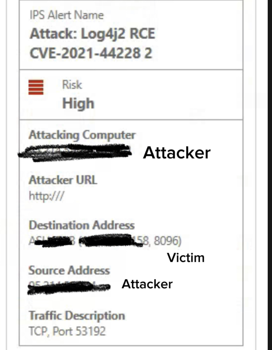

Jaggers 3 Posted May 27, 2023 Posted May 27, 2023 (edited) I have went through my plug-ins folder and plug-in configurations folder and found none of the stated malicious plugins like ReadyState.xml or helper.dll/EmbyHelper.dll neither did my server abruptly shutdown. Does this mean I wasn’t affected by the hack? Do I still have worry about anything else? Though, during that breach on 25th may, I did get some log4j attacks which my Norton antivirus blocked. Do you think this is part of the vulnerability? If not, what do you suggest I do? (The attacker did stopped trying after 2 days after the data breach) Edited May 27, 2023 by Jaggers

Solution Luke 42290 Posted May 28, 2023 Solution Posted May 28, 2023 hi, looks like you're not affected. That screenshot appears to be someone trying to sign into your server. By the way, a good way to make it less likely that you'll see these kinds of attempts is to use a different public facing router port besides the defaults. If you decide to change this, make sure to update emby server network settings to make the server aware of it.

justinrh 270 Posted May 28, 2023 Posted May 28, 2023 But the log4j alert is not from Emby server app, is it?
Jaggers 3 Posted May 28, 2023 Author Posted May 28, 2023 Just now, justinrh said: But the log4j alert is not from Emby server app, is it? No. I didn’t receive any “try to login” alert on my dashboard. This is from Norton.
justinrh 270 Posted May 28, 2023 Posted May 28, 2023 I understand Norton reported the alert, but what app is triggering the alert (i.e., using log4j)?
Jaggers 3 Posted May 28, 2023 Author Posted May 28, 2023 Just now, justinrh said: I understand Norton reported the alert, but what app is triggering the alert (i.e., using log4j)? There was no app. Some person is trying to enter my Emby server in a malicious way.
justinrh 270 Posted May 28, 2023 Posted May 28, 2023 Then it is the Emby server app. I'm wondering why Emby would trigger this. You are on a Windows box?
Jaggers 3 Posted May 28, 2023 Author Posted May 28, 2023 1 minute ago, justinrh said: Then it is the Emby server app. I'm wondering why Emby would trigger this. You are on a Windows box? Yes. I’m using windows.
visproduction 338 Posted May 29, 2023 Posted May 29, 2023 Looks to be an attack from Kursk Oblast in Russia: https://www.microsoft.com/en-us/security/blog/2021/12/11/guidance-for-preventing-detecting-and-hunting-for-cve-2021-44228-log4j-2-exploitation/ https://www.crowdstrike.com/blog/log4j2-vulnerability-analysis-and-mitigation-recommendations/
mcalbert007 2 Posted May 29, 2023 Posted May 29, 2023 hey all, i didn't want to make another post for the same thing but i'm receiving the same attack on a daily basis, It's been happening for around 2 weeks now Category: Intrusion Prevention Date & Time,Risk,Activity,Status,Recommended Action,IPS Alert Name,Default Action,Action Taken,Attacking Computer,Attacker URL,Destination Address,Source Address,Traffic Description 29/05/2023 17:53:46,High,An intrusion attempt by 95.214.55.244 was blocked.,Blocked,No Action Required,Attack: Log4j2 RCE CVE-2021-44228 2,No Action Required,No Action Required,"95.214.55.244, 37608",http:///,"DESKTOP-4IOLCPI (MYIP)",95.214.55.244,"TCP, Port 37608" Network traffic from <b>http:///</b> matches the signature of a known attack. The attack was resulted from \DEVICE\HARDDISKVOLUME4\USERS\MYNAME\APPDATA\ROAMING\EMBY-SERVER\SYSTEM\EMBYSERVER.EXE. i'm not sure what's going on with this but would really like it to stop, after the revelation about the hack thing recently, i checked my files and couldn't find any of the files mentioned in the clean up action. my server never stopped working or loading so i feel like i'm safe but i'm still a bit worried that this is continuing. I will make the suggestion made here to change the outward facing port a different one, hopefully this will end this. Is there anything else that needs or can be done to ensure my pc is safe. thanks for any help you guys can give
