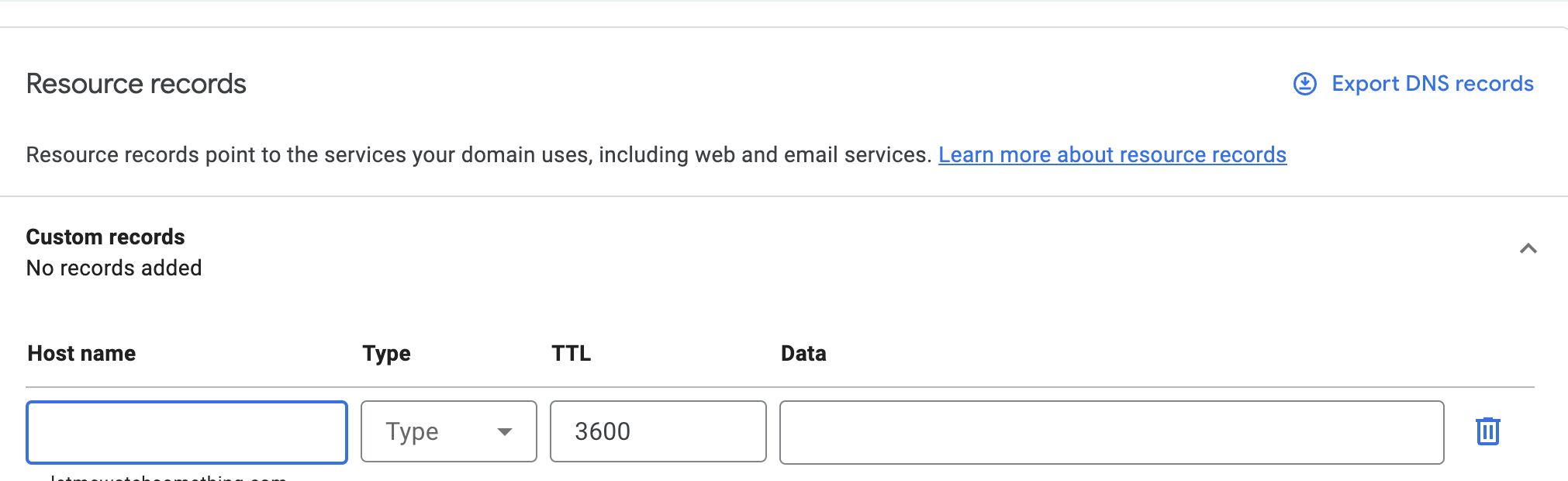

Samus512 2 Posted May 27, 2023 Posted May 27, 2023 I just got a google domain. could someone provide me with information how to set it up and create a ssl cert.
Samus512 2 Posted May 27, 2023 Author Posted May 27, 2023 I'm getting confused with how to connect my home IP with google domain. I dont see where to input my home ip under dns.
Samus512 2 Posted May 27, 2023 Author Posted May 27, 2023 I figured out where to out the ip. it was under forwarding. completely missed that tab the first time.

Samus512 2 Posted May 27, 2023 Author Posted May 27, 2023 how do you set up an A record with google domain? is that the dns custom record?
pwhodges 2023 Posted May 27, 2023 Posted May 27, 2023 Google has instructions: https://support.google.com/a/answer/2579934?hl=en Paul 1
Samus512 2 Posted May 27, 2023 Author Posted May 27, 2023 I got the A record set up. So now i have to use lets encrypt to create the ssl is what i'm understanding from the provided link from Luke? Also does using the domain to connect make the open port more secure or is that only when adding the ssl cert that it provides my open port security?
