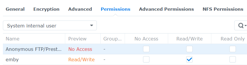

didierblaylock 3 Posted May 27, 2023 Posted May 27, 2023 Just set up my new NAS and installed the Emby package. I've copied over my media shares from my old WD MyCloud and set the permissions for the System Internal emby user. I have not yet restored the backup from my old Windows Emby server. When I go to add a library it says it can't find the folder. I can access the folder from a Windows client with no issues so I'm not sure what I'm doing wrong. Is there a guide/tutorial that goes through the server config on Synology step by step? I'm guessing I'm missing something very simple.
FrostByte 5453 Posted May 27, 2023 Posted May 27, 2023 (edited) Does this help? Make sure you give the "system internal user" emby user permissions. Edited May 27, 2023 by FrostByte 1
didierblaylock 3 Posted May 28, 2023 Author Posted May 28, 2023 As I mentioned in my post I've already done that. Can't quite figure out what I'm doing wrong.
FrostByte 5453 Posted May 28, 2023 Posted May 28, 2023 (edited) What is your shared folder name then? is it "Emby"? If Emby is your shared folder then it should look something like this assuming you're storing your movies in subfolder Movies. Also, it may be case sensitive /volume1/Emby/Movies \\192.168.1.194\Emby\Movies Edited May 28, 2023 by FrostByte
didierblaylock 3 Posted May 28, 2023 Author Posted May 28, 2023 Apparently it was just a matter of waiting or possibly a reboot of the NAS. I went back to it a little while ago and it's now letting me add the libraries. Thanks for your assistance. One issue I'm having now is that I'm getting the Continue Watching section on the Home Screen but I'm not seeing the individual libraries under that the way I did before. Any thoughts? They aren't options in the Home Screen drop downs in the server manager either. 1 1
