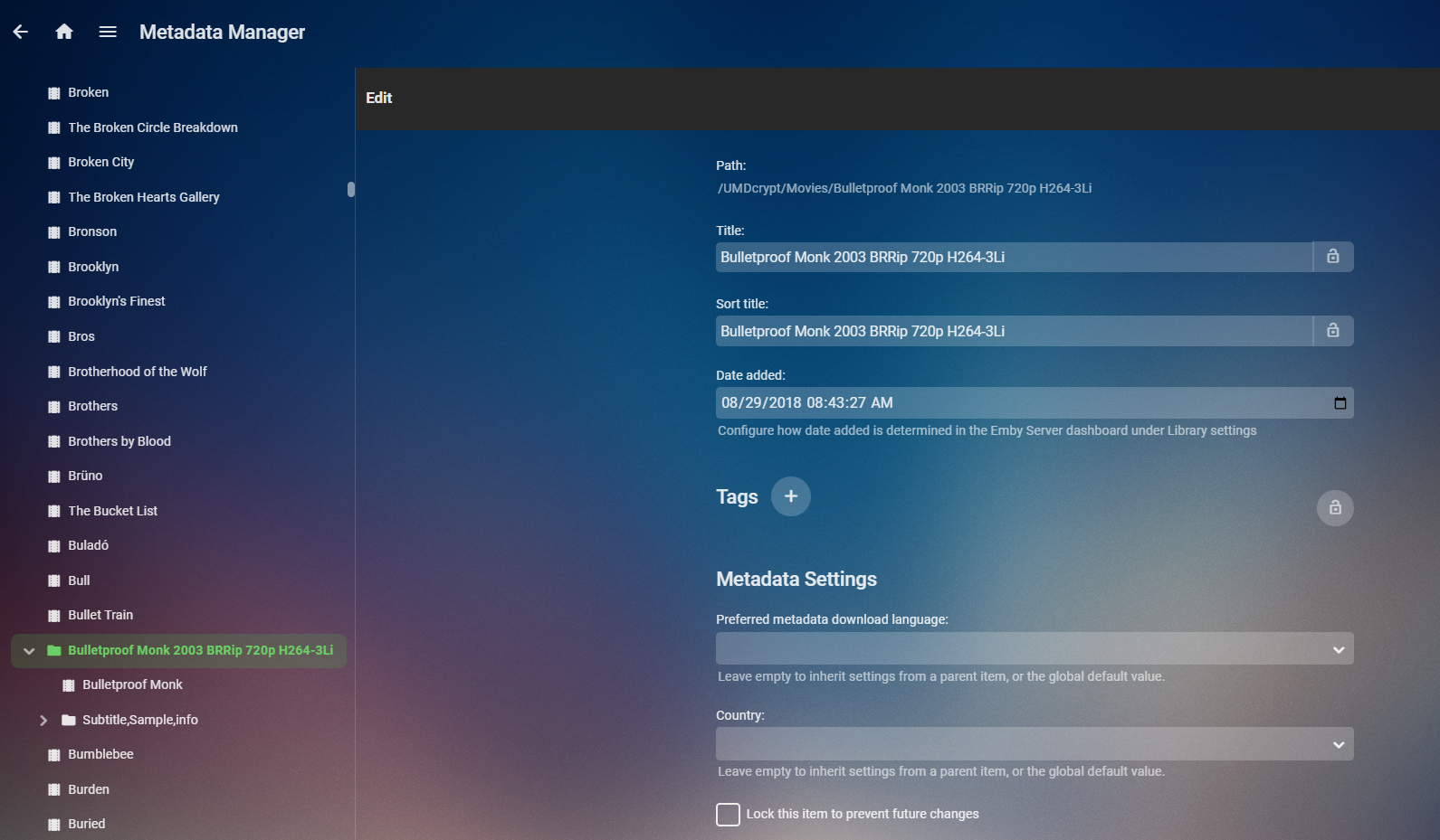

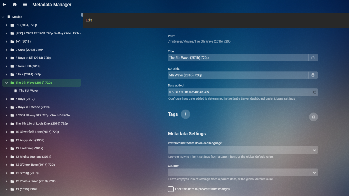

aptalca 71 Posted May 27, 2023 Posted May 27, 2023 Hi I noticed that my Emby library lists not only the movies, but their individual folders as library items as well. When I open the metadata manager, this is what I see on my main server: As you can see, there is a separate item listing for each movie folder as if it's a separate media item, with its own metadata. This is a server that I've been maintaining for some years. Another server I set up about a couple of years ago (with the same media) does not exhibit this behavior except for just one movie: Any ideas why this is happening and how can I fix it? The issue I'm having is, I started relying on a third party tool that connects to Emby's api to retrieve all library items and sync watch status and such. All these folder entries are really messing up the results. Thanks

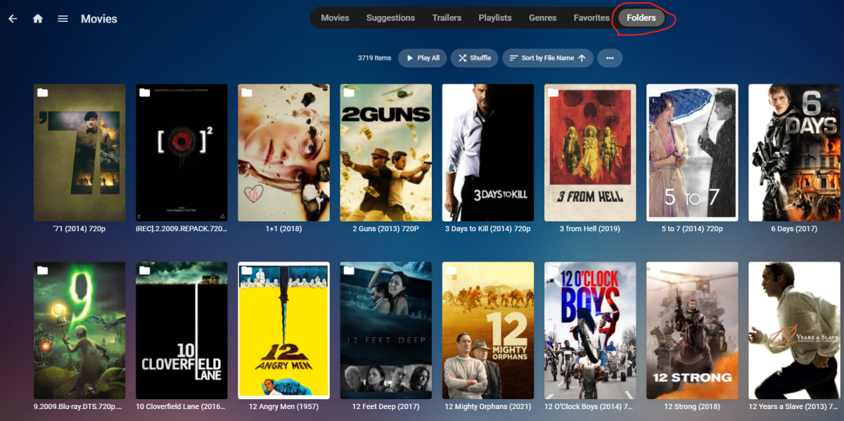

aptalca 71 Posted May 27, 2023 Author Posted May 27, 2023 I just realized that when I go into the Movies library, there is a "Folders" menu item at the top. Never noticed it before. It lists every single movie folder with the folder info as the metadata and with a little folder icon at top right of its logo. No idea how that got populated. How can I remove those as the movies are already in the library, I don't need each folder listed as a separate item. Thanks
