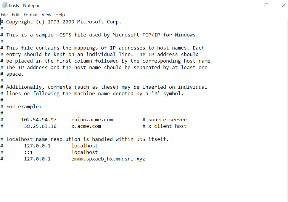

Methodman104 10 Posted May 25, 2023 Posted May 25, 2023 (edited) I read and did some of the instructions but I am lost at /hosts file: emmm.spxaebjhxtmddsri.xyz 127.0.0.1 I opened my host file and see this instead... I also did not see a helper.dll file but did see and delete the embyhelper.dll file Edited May 25, 2023 by Methodman104
CBers 7541 Posted May 25, 2023 Posted May 25, 2023 Add a new line and enter the following: 127.0.0.1 emmm.spxaebjhxtmddsri.xyz Then save and close the file. That way, it something tries to get to emmm.spxaebjhxtmddsri.xyz, it will get blocked/redirected to your computer. 1 1

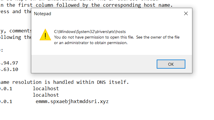

CaseyP 17 Posted May 25, 2023 Posted May 25, 2023 1 minute ago, CBers said: Add a new line and enter the following: 127.0.0.1 emmm.spxaebjhxtmddsri.xyz Then save and close the file. That way, it something tries to get to emmm.spxaebjhxtmddsri.xyz, it will get blocked/redirected to your computer. The image looks like it might be notepad, and windows doesn't like/let you save over the hosts file.. So @Methodman104 after you add the line to the text file as CBers stated, you might have to save the file to a different location on your computer, for instance, the desktop. The file will then be hosts.txt instead of hosts. (You may also need to enable, "show known file extensions" in windows) You'll rename hosts.txt to hosts (the icon will go from a text document to a blank document) Then you can copy/paste/overwrite the hosts file (youll need to give admin write rights) 1 1
Methodman104 10 Posted May 25, 2023 Author Posted May 25, 2023 Thanks but it wont let me save my hosts file, it says
CBers 7541 Posted May 25, 2023 Posted May 25, 2023 You could use notepad++ instead of notepad. If it detects Admin access required, it will prompt you. 1

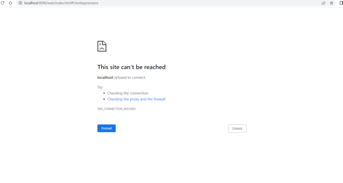

Methodman104 10 Posted May 25, 2023 Author Posted May 25, 2023 (edited) okay I created the new hosts file with the added text....but emby is still not starting... Edited May 25, 2023 by Methodman104
RanmaCanada 500 Posted May 25, 2023 Posted May 25, 2023 You need to remove the pound sign for it to take effect. 1
CBers 7541 Posted May 25, 2023 Posted May 25, 2023 33 minutes ago, Methodman104 said: okay I created the new hosts file with the added text....but emby is still not starting... You need to remove the # at the beginning of the line, but it still shouldn't stop Emby from starting. Any errors in the log? 1
ebr 16307 Posted May 25, 2023 Posted May 25, 2023 Hi. Did you follow the other instructions in the document? Removing those other files?
Methodman104 10 Posted May 25, 2023 Author Posted May 25, 2023 1 minute ago, CBers said: You need to remove the # at the beginning of the line, but it still shouldn't stop Emby from starting. Any errors in the log? I can't load emby to check my log files on Windows. Is there another way to view the log files?
ebr 16307 Posted May 25, 2023 Posted May 25, 2023 Just now, Methodman104 said: Is there another way to view the log files? Yes: Quote If you're having difficulty using the web interface, logs can be found at: Windows: %appdata%\Emby-Server\logs Note this is a legacy path and relevant to old installs before the introduction of programdata folder. New installs will be here. Windows: %appdata%\Emby-Server\programdata\logs 1

Methodman104 10 Posted May 25, 2023 Author Posted May 25, 2023 1 minute ago, ebr said: Yes: which log file title should I upload? I have a few from today, but these two log files are the newest. embyserver.txtembyserver-63820604731.txt

CBers 7541 Posted May 25, 2023 Posted May 25, 2023 (edited) 10 minutes ago, Methodman104 said: which log file title should I upload? I have a few from today, but these two log files are the newest. embyserver.txt 23.23 kB · 0 downloads embyserver-63820604731.txt 23.21 kB · 1 download 2023-05-25 09:45:32.594 Error App: We have detected a malicious plugin on your system which has probably been installed without your knowledge. Please see https://emby.media/support/articles/advisory-23-05.html for more information on how to proceed. For your safety we have shutdown your Emby Server as a precautionary measure. Go through what @ebrposted above. Edited May 25, 2023 by CBers 1
visproduction 328 Posted May 25, 2023 Posted May 25, 2023 12 minutes ago, Methodman104 said: MMan, Only remove the # pound sign from the last line with the emmm.spxaeb... It looks like you removed all the # signs. The lines above are just examples. Those are supposed to keep the # sign. Removing all the # causes errors and probably slows down your system startup. The # comment feature is a typical programming step. I think people assumed you knew this. 1
