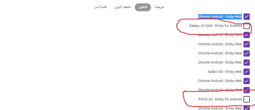

estra7ah 2 Posted May 24, 2023 Posted May 24, 2023 اريد الغاء الدخول عن طريق التطبيق واسمح للمستخدمين يدخلو عبر المتصفح فقط مع العلم اني حاولت الغي من اعدادات المستخدم ولكن يتم حظره من المتصفح والتطبيق معاً .. هل هناك طريقة لحظر التطبيق والدخول بالمتصفح فقط . وشكرا لكم

estra7ah 2 Posted May 29, 2023 Author Posted May 29, 2023 @كارلو I tried this way but the device blocked on app and browse too .. isn't there another way to block the user on app only ?
Luke 42287 Posted May 29, 2023 Posted May 29, 2023 1 hour ago, estra7ah said: @كارلو I tried this way but the device blocked on app and browse too .. isn't there another way to block the user on app only ? The problem is device access is a bit of an awkward feature. You have to first grant the user access to all devices so that they can sign in once with the device before it will show up in the list. Then after that, then you can check the box you want. Then to grant the same user access to new devices, you have to repeat the process again. Anytime the user's browsing data gets cleared, you'll also have to go through this process again. So I don't recommend using it to control access to browsers.
