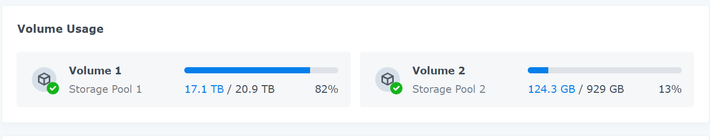

Solution kaj 339 Posted May 24, 2023 Author Solution Posted May 24, 2023 Bit the bullet and went ahead and manually installed DSM7.2. I stopped Emby first, download the beta .37 package for DSM7.2, ran the script from here, and then ran the DSM update. Nerve-racking as I'm 2500km from my server. Everything installed as expected. Checked my SSD volume 2. It's still there, health good, but showing: As it's all working this is not a problem, as showing this in the Storage Manager. Maybe another reboot of the NAS might sort this out, some have said that works. Then installed Emby beta .37, which went without a hitch. Had to run a library rescan to pick up content that had been added while I was installing the updated .37 package. Also, all my docker containers moved and ran automatically in the new Container Manager app. 2 1

Carlo 4561 Posted May 25, 2023 Posted May 25, 2023 I've never pinned containers to the desktop in Synology either so I'm not of help. I'd make a post in their forums to ask how this could be done on 7.2. Concerning the DSM 7.2 upgrade for anyone who followed my instructions previously to allow use of NVMe drives as volumes you have nothing to worry about. The GUI still won't show things correctly but the volume(s) created will work just like they did on 7.0 and 7.1. Be aware that DSM 7.2 will require a new build of Emby Server built for this which you can down from or normal download site. All you need to do is apply the DSM 7.2 to the Synology system followed by the installation of the new 7.2 build of Emby Server and you're set. Carlo 2
