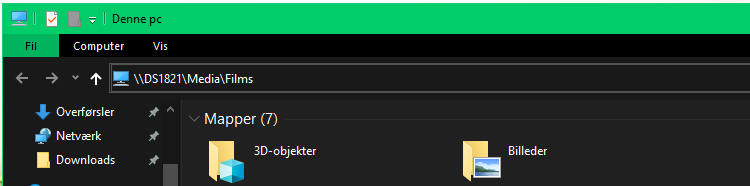

Neminem 1630 Posted May 23, 2023 Posted May 23, 2023 Can you from your server see \\DS1821\Media\Films in your explore.
