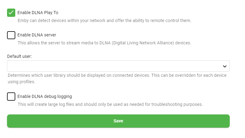

musicmafia 38 Posted May 22, 2023 Author Posted May 22, 2023 10 minutes ago, Luke said: .......Anyway, you could try turning off Emby Server DLNA features, then restart the server and the TV, and see if the flagging stops. Thanks Luke. Here's what I have now. I don't think I clicked anything there, so I assume these are default settings? So I should untick all? Should I set my account as default user (it's blank now)?
Luke 42289 Posted May 22, 2023 Posted May 22, 2023 Granted it won't stop your TV from sending out upnp queries, it will just stop the server from responding to them. So see if that helps. 1
