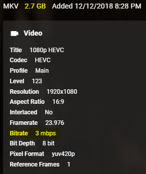

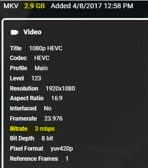

I've monitored the GPU / CPU on my server during these conversions & noticed they both sit around 20% usage during conversions.
I tested running some ffmpeg conversion outside of emby (very basic commands) & confirmed that they use more of 70 - 80% of my GPU.
Reviewing conversion logs, I'm seeing fps about 50 & speed between 1.5 - 2 & bitrate below 3kbits/s
When running outside of Emby I'm seeing fps about 85, speed between 3.4 - 4 & bitrate around 9kbits/s
I want Emby Conversions to utilize all / most of my GPU. I feel this will speed up the conversion time as well as the quality of the video output
I'm also concerned that the file being output isn't original quality as they are roughly 10x smaller & bitrate is much lower.

Hi, in the upcoming 4.8 server release you should see a higher output bitrate with these conversions. That in turn may increase the gpu consumption during the conversion process.

It’s related to the params being passed to ffmpeg.
