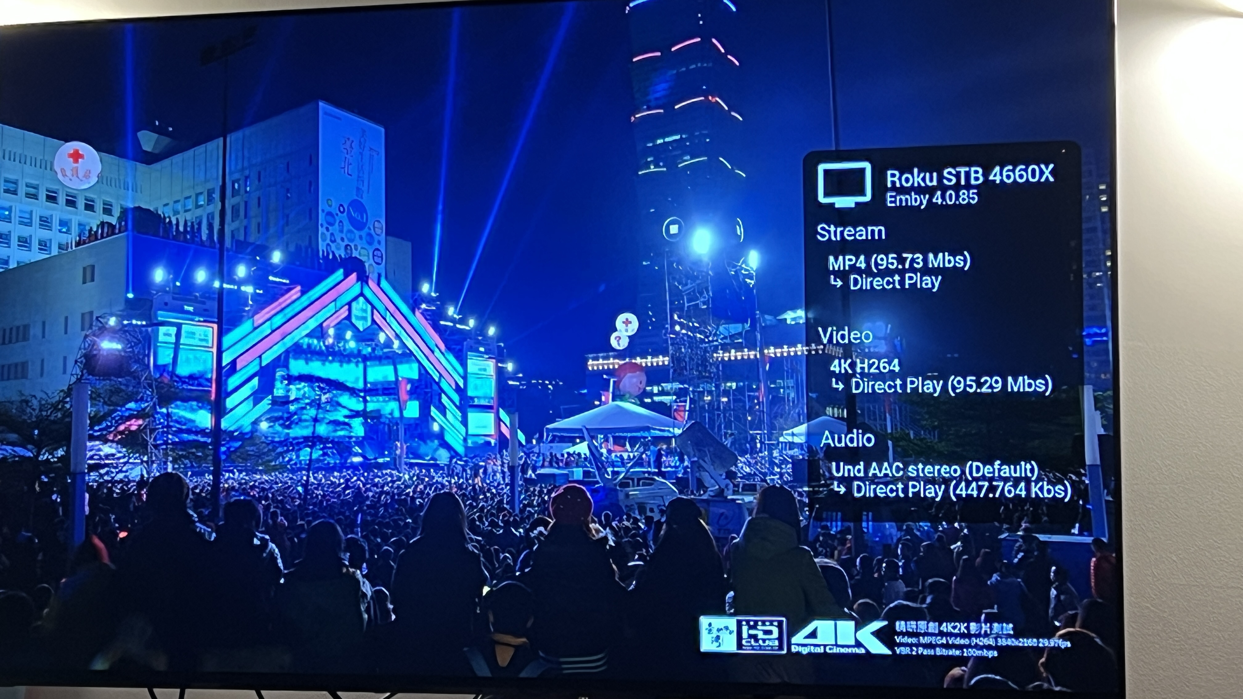

jlficken 3 Posted July 8, 2023 Author Posted July 8, 2023 This is the highest I’ve got available currently at 95Mbps and it plays fine over WiFi.
